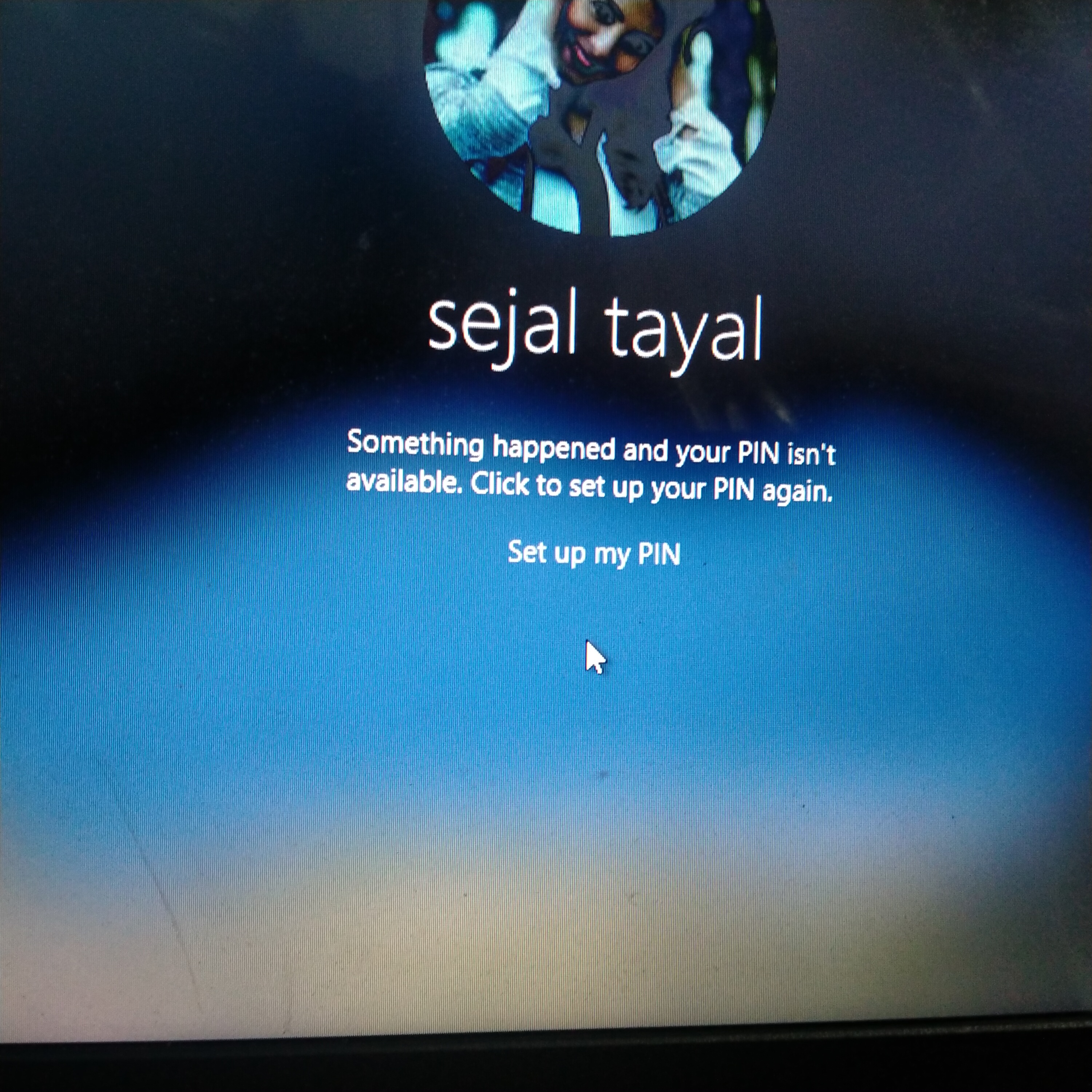

I have a new PC with W10. I decided to use the PIN code, but now I get the message "Something happened and your PIN isn't available. Click to set up your PIN again."
When I click 'Set up my PIN' nothing, the same message reappears.
I looked up the issue on the internet and found that I should login using another sign-in option. However, there is no way to get to another option. The text above is all I see on the screen.
