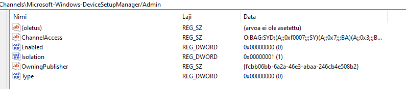

    1. Edit the registry:
    HKEY_LOCAL_MACHINE\SOFTWARE\Microsoft\Windows\CurrentVersion\WINEVT\Channels\Microsoft-Windows-DeviceSetupManager/Admin "Enabled"=dword:00000000 HKEY_LOCAL_MACHINE\SOFTWARE\Microsoft\Windows\CurrentVersion\Device Metadata
"PreventDeviceMetadataFromNetwork"=dword:00000001
This issue should be solved temporarily by the above method, if you want to completely solve this issue, it may require the development team to fix it, you can submit your ideas and suggestions through the [Feedback Hub](https://support.microsoft.com/en-in/help/4021566/windows-10-send-feedback-to-microsoft-with-feedback-hub-app "support.microsoft.com"), and the development team will regularly review submissions for ideas or fixes. Please share the feedback link here after submitting as it will allow others on the forum to vote for your submission, including me. More votes will lead to more visibility and higher priority to the development team.
