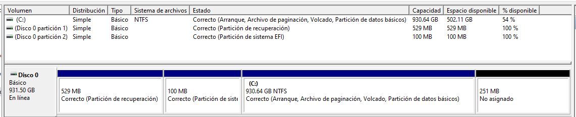

    In my case id did not work.
    My recovery partition is Partition 1
    (My OS is in Spanish)
