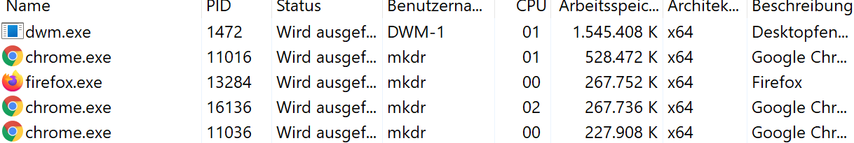

The infamous dwm.exe hogging lots of memory. FYI this is not a specific program issue. It just happens with any programs, activities randomly.
I'm getting really tired of killing dwm.exe every so often so that it will release the occupied memory. When is this going to be fixed? Is this ever going to be fixed even?
