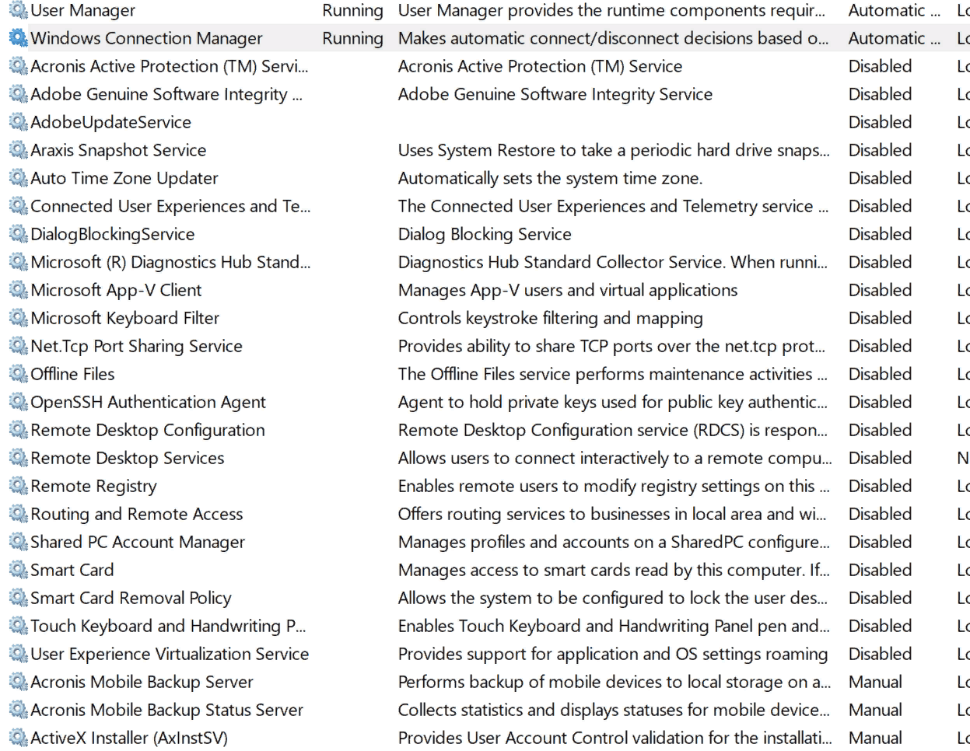

    Restarting dozens of network services under "services.msc" has no effect.
    See disabled services below...
