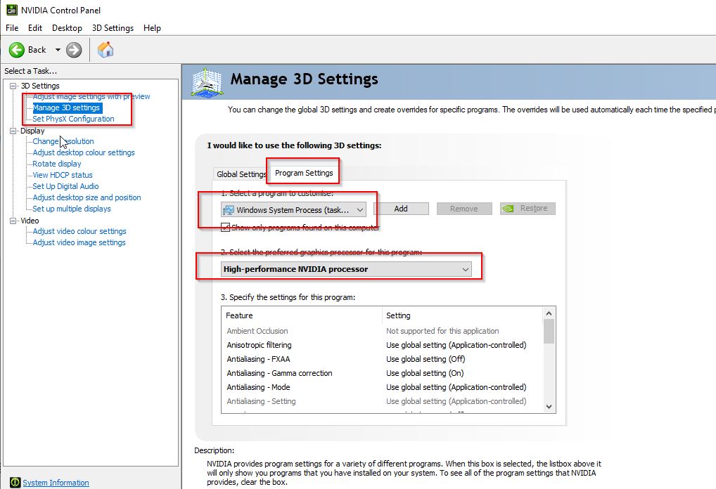

    I had a similar issue for my laptop after a windows update, my task manager used to crash when I take the performance tab. I just got it fixed right now. May be this step will be helpful.
    Below are the steps i did
    1. I took the NVIDIA control panel
    2. I selected Manage 3d settings from the right panel.
    See the below diagram for your reference. In the  Programm settings (Left side), I selected task manager and the preferred graphics processor as NVIDIA. For me Integrated graphics was selected as default. After applying this change, now I am not facing any issues
