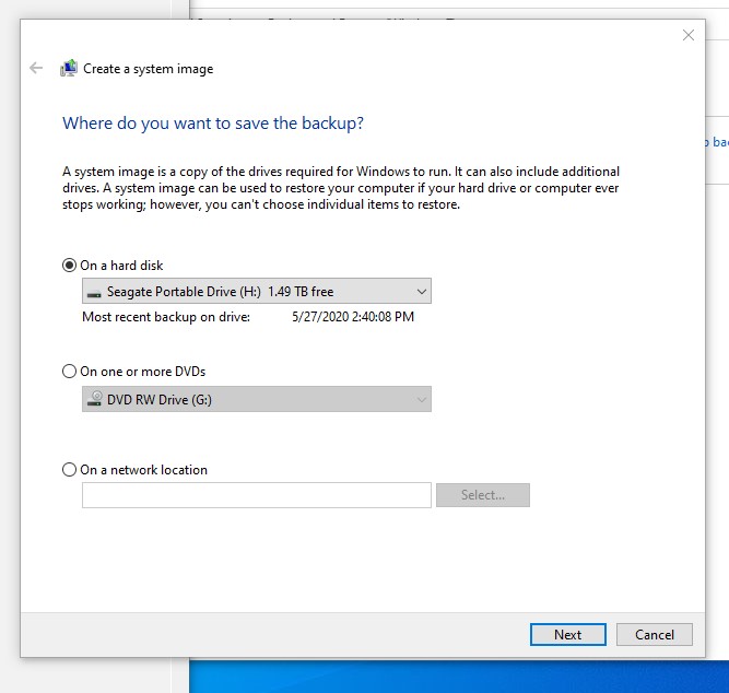

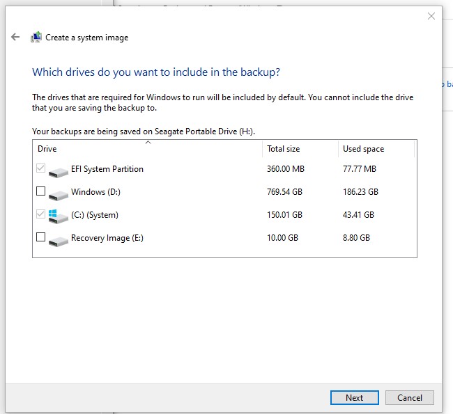

    I said "The image back up finished. I think I added this D: because as seen above, here it's not the recovery space any longer. That became E:. Each time I plug in a new drive or USB the identifying Letter all rename themselves except C: instead of just adding the next vacant letter they get rearranged. Naming them didn't help. I don't remember this happening in other, older computers I've had so I thought it was a MS 10 update thing."
    Before 1909 was added, the D: drive was the HP recovery I believe. Like you say Recovery jumped to E: and D: became the 1809. I think originally there were only three choices but I might be wrong, so many tries, my brain is fried.
    So should I do the clean install from the usb? And cross my fingers?
    2020-05-28T02:18:16+00:00
    I thought you said E: wasn't offered?
    (a) D: is 1809.
    (b) E: is the Win 8.1 recovery partition.
    (c) 1809's recovery environment partition is not offered, neither is Win 8.1's..
    (d) EFI is shared by 1809 & 1909.
    (e) C: is 1909, & it has its recovery environment (Shift+Restart) in a folder.
    So, leave D: & E: unchecked. Those are wasted space on the HDD. Also, I'm unsure 2004 will like them when it comes to upgrade you again.
    2020-05-28T01:29:37+00:00
    Here's what mine says
