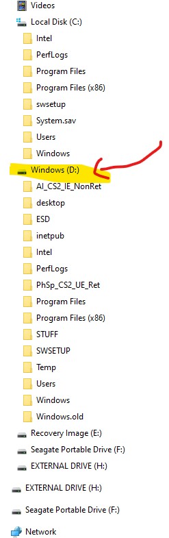

    Here are your partitions...
    Local Disk is the name of your 1909 partition. It is C: when you boot to it. Otherwise, it's D:.
    Windows is the name of your 1809 partition. It is C: when you boot to it. Otherwise, it's D:.
    Recovery Image is your old D:. It's been pushed to E:.
    Soon, we want to delete all of your partitions & redo the clean install. Then you will have EFI, MSR, Windows (C:), & Recovery -- all of it belonging to 1909. I'm satisfied your computer can take 1909 because DISM, SFC & Windows system image all worked. Are you satisfied yet that your apps will work in 1909? Then let us proceed to the next step. We have to nuke it all & redo the clean install.
    No wonder the image took so long to make. It included both 1809 (D:) & 1909 (C:). Did it offer E: too & did you select it? Then it's got Win 8.1 too.

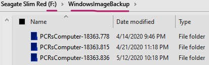

    (1) Let's rename the image to keep it separate & distinct from the next one...
    (a) Plug in the external HDD that holds the image.
    (b) Open the WindowsImageBackup folder on it.
          You'll see one folder inside with the name of your computer on it.
    (c) Append "-1909_with_1809" to its name.
    That's the name you'll see, if/when you must restore that image. The next time you make an image, append something to its name too. I delete the oldest one before making a new one, so that I always have three...

    2020-05-26T15:48:15+00:00
    The new 1909 set up changed some of the disk names Here's what file manager says now  D is now some of my old C:\ disk folders the H: is not my usb -it's  not plugged in at the moment; it's another external drive I was getting programs installed from.
    The image back up finished. I think I added this D: because as seen above, here it's not the recovery space any longer. That became E:. Each time I plug in a new drive or USB the identifying Letter all rename themselves except C: instead of just adding the next vacant letter they get rearranged. Naming them didn't help. I don't remember this happening in other, older computers I've had so I thought it was a MS 10 update thing.
    I am being told that I don't have permission to access most of my folders. Click to continue to permanently get access. Should I do this for every folder?
