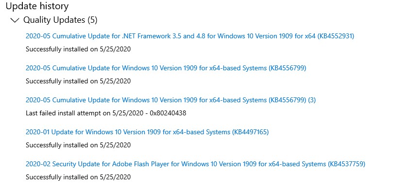

    Am running in 1909 There was no volume screen this time. The options at start up are Windows 10 or Win 1809.
    The updates ran all day and it now says it's complete with these quality updates plus other security/device updates.  I double checked and ran check for updates just to make sure.
    This is the OS build now
    Is this right?
