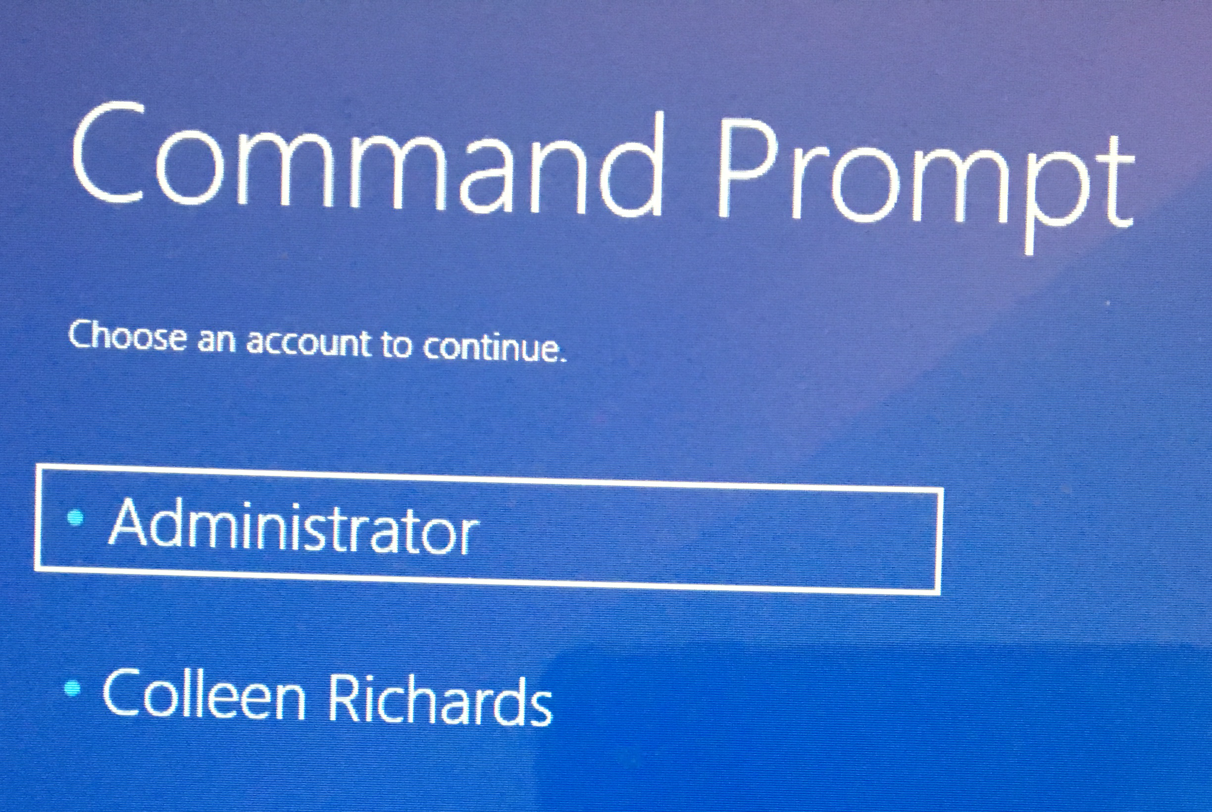

    2020-05-07T04:38:59+00:00
    (1)
    (a) When you switch on your computer & sign in - it should be to your user account. The Administrator account is for emergencies (& probably should be shut off until then). It is good you haven't been initiating the 1909 upgrade in the Administrator account. I don't think it is amenable to it.
    (b) You change those drive letters in the internal recovery environment (Shift+Restart). That's where they are messed up. When you enter the Command Prompt there, you are asked to select a user & then for the password. I think you said both the Administrator & your user account allowed you in. So - use the user account. If it fails, use the other. That would be an emergency.
    (2) That's right. When you "copy", it goes into the Clipboard. When you "paste", it comes out. But the Clipboard is cleared when Windows boots. It might not even be the same Clipboard for all I know. So, you can't use it to get text from the recovery environment into Windows.

    2020-05-06T16:34:39+00:00
    Need to know before I try  4) manually changing drive letters - should that done be through administrator of my account? I would assume admin but not sure how messed I make things if I was wrong.
    I don't know about a Built-in-administrator account compared to what appears on my pc or how to turn it on or off for that matter. It's always just been Administrator. Start up has always asks to choose account - Administrator or mine; I use mine. All updates were/are tried while in my account only.
