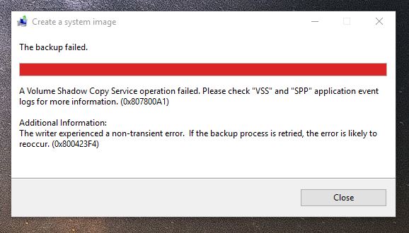

    Tried file history and that finally worked after unclicking everything and reselecting it again.
    Got this message  for backup
    ![](https://learn-attachment.microsoft.com/api/attachments/43481a6b-42c2-479f-9e55-45f0fb007028?platform=QnA is what the cmd saild. Looks like yours for the most part.

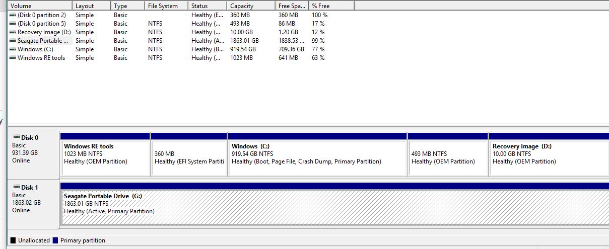

    Well, I've been back & did begin a lengthy write-up, but now I notice you did already expand the right partition...
    The numbers didn't come out precise, but they didn't for me, either. Importantly, you've got a Recovery partition under 500 MB & with over 50 MB free. (Mine is over 500 MB & now has over 320 MB free space. But all was working well for me before. So -- I'm doubtful now you actually will be cured of anything...

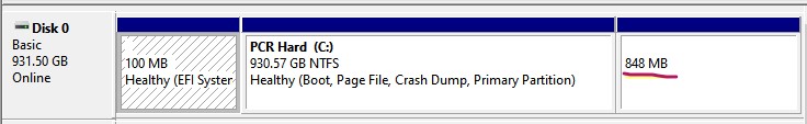

    Attrib  : 0X8000000000000001         <<< Was all zeros after Partition Assistant was done.
    Offset in Bytes: 999313944576
      Volume ###  Ltr  Label        Fs     Type        Size     Status     Info
    * Volume 3         WinRE 1909   NTFS   Partition    847 MB  Healthy    Hidden

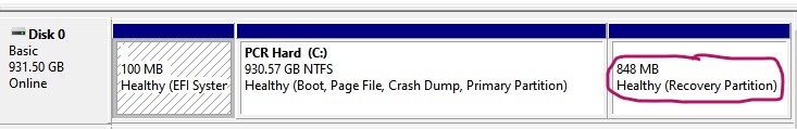

    Also, it will look better in Disk Management, changing from...
    ...to...
    Check whether you can make a Windows system image backup now. It would be nice, but the condition wasn't affecting me. So, I'm doubtful it cured anything.
