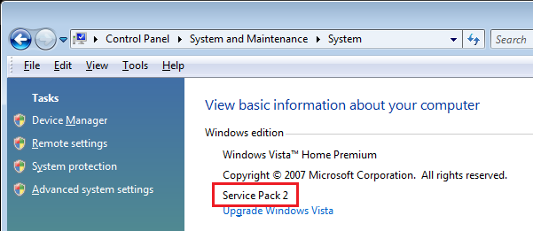

    ... and further to my previous reply, if you are not sure if Service Pack 2 (SP2) is installed check at Control Panel | System and Maintenance | System as shown in the image below.  Download links for any missing service packs are provided in RayPilkington's Re-installing Windows Vista thread.
