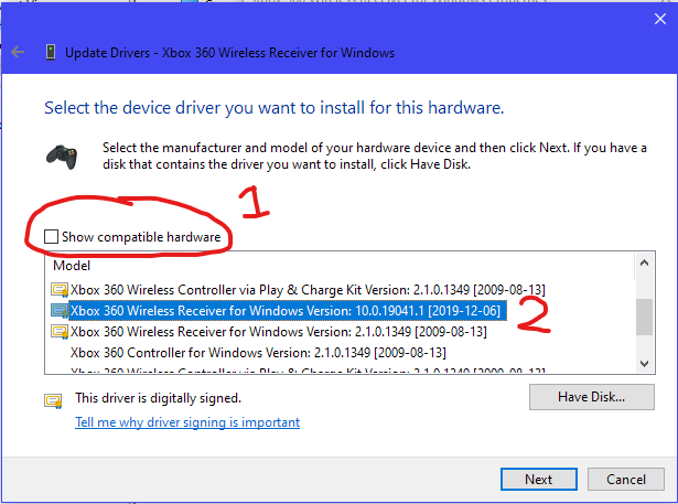

Hello. I just updated to Windows 10 version 2004 yesterday, and today the wireless receiver for the Xbox 360 controller stopped working. According to the Device Manager it has turned into an "Unknown Device" without any driver installed. I tried updating the driver using the one from the list (The "Let me pick from a list of available drivers on my computer" option), it said that it was installed successfully, but when I clicked "close" and went back to Device Manager, it is still an Unknown Device. I have rebooted the computer several times, still had the same issue. It seems like the only solution left is to go back to the previous version but it's going to take way too long. Does anybody else have this issue or know how to resolve this issue? Thank you!

    I found that I could install the original driver like Thunderz2016 mentioned, and that fixed the Forza issue.  Try that.

    Hmm that's weird. After following the video posted by Steve I just opened Device Manager, went to the receiver, "Update Driver", Browser my computer for drivers, pick from the list, **unchecked "Show compatible hardware"**and then chose Version 10.0.19041.1 [2019-12-06]. After a few seconds it told me that the driver was successfully installed.
