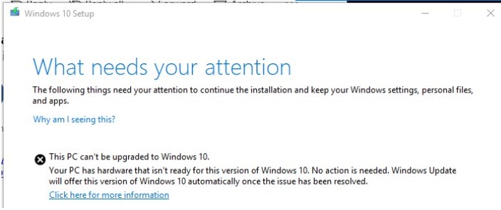

    (3) I found an old thread in which I said it was 1903 that I installed over itself. Apparently, when it first came out, the MediaCreationTool (MCT) fetched OS Build 18362.30. As an .ISO, it worked to upgrade 1809>1903. On a USB, it would not upgrade 1809>1903. It gave an error message: "This PC can't be upgraded to Windows 10"...
    But when the MCT fetched 18362.175, that did work to do the over-install 1903>1903 from USB installation media. That was back in July, 2019. As you know, one must run DISM on Install.esd to know the OS Build...

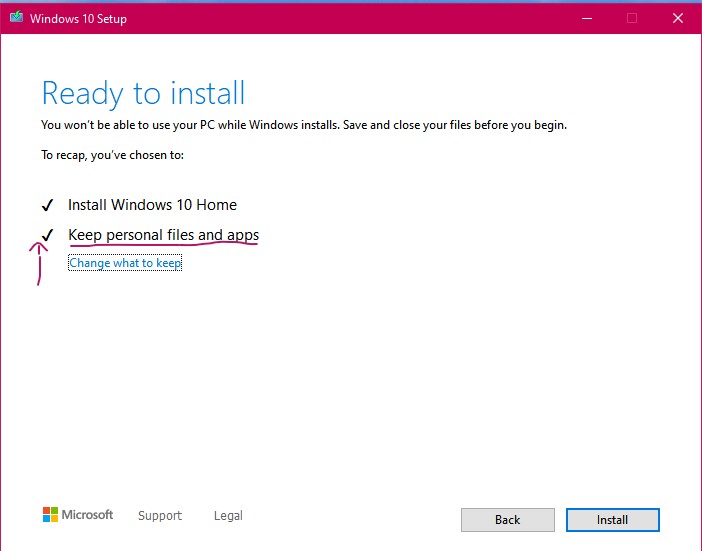

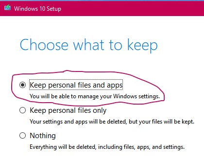

    2020-02-26T21:18:46+00:00
    I doubt what you say is wrong, but it appears not to be true for everyone. I know I installed 1909 twice, but just can't quite recall whether the 2nd time was over itself or again over 1903. Definitely I lost no files or apps. Now I plugged in my USB Installation drive & clicked Setup.exe (which indeed is 18362 as you say). Here is what I get & currently I am 1909...
    After clicking "Change what to keep", I get...
    None of the choices is shaded or unavailable. However, I've seen your point before, & I used to warn folk to be sure they see that or to back out. I'll try hard to remember to include that warning again. Thanks for the reminder.
    Edit:  Or it might have been that 1903 is the one I installed twice, probably the 2nd time over itself..

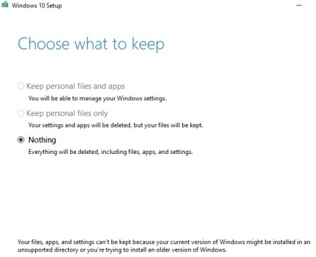

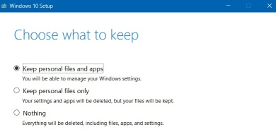

     Yes, variation does exist. In some cases the differences are hard to pin down exactly why. Since that variation does exist using the MCT 1909 created media(USB/DVD, mounted ISO) when attempting to perform an in-place/over the top install it as you noted is important to mention
     - the end-user may receive one of these two screens(one option to keep Nothing, the other option to with all three options)
    For those attempts that yield the 'Keep Nothing' option the resultant setupact.log may show the reason(see below)
    Host OS version: 10.0.18363.0  (0.0) Platform 0x2, SuiteMask 0x300, ProdType 0x1
    Target OS version: 10.0.18362.592
    ConX::Compatibility::
     - the HOST is the current Win10 on the device (it may look backwards but its not, the Target is the version that the setup grabs from the MSFT servers during the install process[Note: the version, iirc will change depending upon the current cumulative update available)
    While not a consolation at this time for those receiving the 'Keep Nothing' option the upcoming feature update 20H1(aka 2004) may once again provide a unique Win10 MCT created media(unlike the current MCT created 'dual personality'  1909/1903 version)

    2020-02-26T07:44:52+00:00
