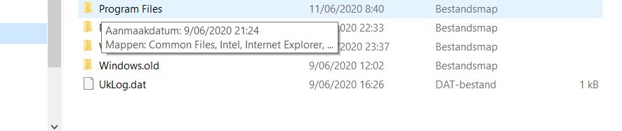

    2020-06-11T07:01:32+00:00
    Hello, I opened "notepad", typed a letter in a new file, saved it anywhere as "uklog.dat", then made it read-only, and copy this file to the root of your system c:\ if your are asked for admin-rights, confirm, already a few days it remains unchanged at 1kb size.
