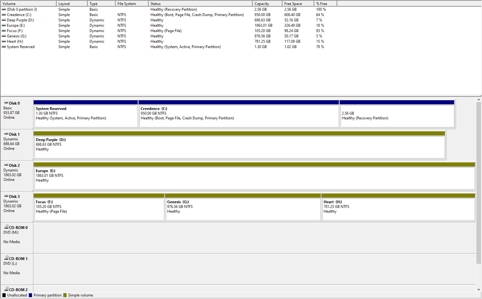

    I detect nothing amiss with any of that. It is a Legacy install. There is only one System Reserved partition, & BCDEdit points nicely to it. ReagentC points nicely to the Recovery partition. I know little of dynamic disks, but they should be OK.
    I think the problem lies elsewhere.

    Thanks a lot for looking into this PCR. I have been struggling for months with some updates... Here's the info...

    2020-11-04T01:54:40+00:00
    Yours is a Legacy install (not a UEFI install). Therefore, partition types are different. I'm less familiar with Legacy, but that type looks OK to me. It isn't flat out stated anywhere I can easily find, but looks like it is a System Reserved partition (which is the equivalent of an EFI that a UEFI install has).
    The problem lies elsewhere, I think. Let's see...
    (a) Right-click START, & select Disk Management.
    Double-click/drag the divider lines in the header to make it readable. Post a picture. I want to see whether there is more than one system partition -- either another System Reserved or an EFI -- maybe on a 2nd internal HDD. That is no good.
