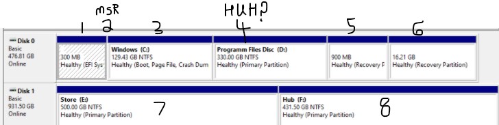

    (1) You selected Disk 1 then listed its partitions...
    DISKPART> list par
      Partition ###  Typ               Größe    Offset
      Partition 1    System             100 MB  1024 KB             <<<EFI
      Partition 2    Reserviert          16 MB   101 MB              <<<MSR
      Partition 3    Primär             203 GB   117 MB               <<<Windows
      Partition 5    Unbekannt           19 GB   203 GB             <<<Not a known partition type
    * Partition 4    Wiederherstellun   521 MB   223 GB        <<<Recovery
    (a) How does partition 4 come after 5? Were you doing partition work of some kind? You should do a reboot as soon as possible after partition work so that the full system knows of the changes. After a reboot, I'm hopeful 4 & 5 will be listed in the right order.
    (b) Unbekannt means "unknown". Normally I'd want to say it was a factory reinstall partition. But those usually have the same partition type of a Recovery partition, i.e., Wiederherstellun. Have you altered its partition type?
    (2) Your ReagentC shows...
    WinRE-Status:      Enabled
    WinRE-Ort:          \?\GLOBALROOT\device\harddisk0\partition4\Recovery\WindowsRE
    Partition 4 is good, but it says "harddisk0". That's Disk 0. So I suspect you've got two complete installations of Windows plugged in at once, which is no good. Especially, you don't want two EFI partitions. Windows can be confused when it does a reboot as to which should be used.
    (3) Your BCDEdit says EFI is on "HarddiskVolume1"...
    Windows-Start-Manager
    Bezeichner           {bootmgr}
    device                  partition=\Device\HarddiskVolume1             <<<Partition 1
    path                    \EFI\MICROSOFT\BOOT\BOOTMGFW.EFI
    HarddiskVolume1 means Partition 1, but which Disk is it referring to? I used to say it would be Disk 0, because it counts partitions starting from Disk 0. But now I think, if you booted directly from BIOS to Disk 1, it might start counting from there. Then, it's saying the EFI on Disk 1 was used to achieve the boot. Do you know if BIOS is set to boot directly to Disk 1?
    (4) Show us a "right-click START, Disk Management". Use the separator lines in the header to make the columns readable. Use the separator line between the panes to scrunch it smaller, but show all the Disks.

    "- So should I change it to Volume1? Is there any risk or this is an easy to proceed thingy? I honestly dont know how its allocated Volume4, since i didnt change nothing once received my laptop (only once i did a factory reset)."
    I just don't know what's up with that. Looking at your Disk Management,..
    I'd expect HarddiskVolume1 would already be there in the BCD. That is because I think it counts the partitions beginning with those on Disk 0 & progressing to the others. I can't think of how it could be saying ...4. Even if BIOS were set to boot directly to Disk 0 (instead of to the Windows boot manager), I'd still expect it be ...1.
    The only exception I think I know is, if there were an OS on Disk 1 & BIOS were set to boot directly to it. then maybe it would start counting with the partitions on Disk 1. But still I can't see how that would come up with a ...4 looking at the partitions you've got, Big puzzle to me how you're getting a ...4.
    Another thing is, I think that value (HarddiskVolume) might be set by Windows during/after the boot. IOW, it may not matter what is in there to begin the boot. It is set afterward to say which system partition was used to accomplish the boot. But really there should be only one system partition, which normally is EFI. If this is true, changing it yourself has no real effect anyway, It may act as just a suggestion to tell Windows where to start looking, I don't really know.
    Maybe, then, your BCD isn't being used at all & it just remains a ...4 from its last use (when presumably there actually was an EFI where it says). But how are you booting now then? Big puzzle. Did you look in BIOS Setup to see what's going on at the Boot page...?...
    https://www.sysnative.com/forums/threads/get-access-to-bios-settings-boot-menu-f-keys-hotkeys-by-system-manufacturer-oem.23010/
    Get access to BIOS settings & Boot Menu: F-keys/Hotkeys by System Manufacturer (OEM)
    Note: That should say what PF key gets to your BIOS Setup, but I know nothing (bad or good) of any links or downloads that are there (or anywhere else).
    (2) "- Im not able to view EFI folder, im not sure even if its existing, is it hidden or something ? Any steps to check this ?"
    Let's see all of this at an Administrator Command Prompt...
    DiskPart                    <<<Enter DiskPart
    Select  Disk  1           <<<Focus on Disk 1
    List  Part                    <<<Maybe there's a hidden partition on it (like MSR is hidden)
    Select  Disk  0           <<<Focus on Disk 0
    Select  Part  4            <<<Focus on partition 4
    Detail  Part               <<<I think we won't see EFI's type because Disk Management doesn't say EFI for it
    Select  Part  1           <<<Focus on partition 1 (EFI)
    Assign  Letter=S       <<<Give EFI the letter S
    Exit                            <<<Exit DiskPart
    DIR   D:\EFI\MICROSOFT\BOOT\BOOTMGFW.EFI  /a       <<<I think the file won't be there
    DIR   S:\EFI\MICROSOFT\BOOT\BOOTMGFW.EFI  /a       <<<I think it will be here
    DIR   C:\EFI\MICROSOFT\BOOT\BOOTMGFW.EFI  /a       <<<Check C:\ too
    Select  Vol=S                 <<<Select the EFI partition by its letter
    Remove  Letter=S         <<<Remove the letter
    Use Ctrl-A & Ctrl-C to copy, then show us. With "/a", the Command Prompt can see what File Explorer may not see. If it says there is no BOOTMGFW.EFI there, then Windows can't possibly be booting from D: partition.
    (3) "- Yes, this is my factory reset partition. Windows come along with 1903 version. But in Oct 2020 i did a factory reset and my windows updated up to 1909 version. Below is history per updates."
    The upgrade to 1909 messed up the ability to do another factory reset. That partition is being used now to hold Windows' recovery environment which really only needs the 900 MB of partition 5. We should switch to partition 5 for that. Then repurpose partition 6 to be a data partition or give its 16 GB to C: partition. After that, make your own system image(s) of 1909 onto external media.
