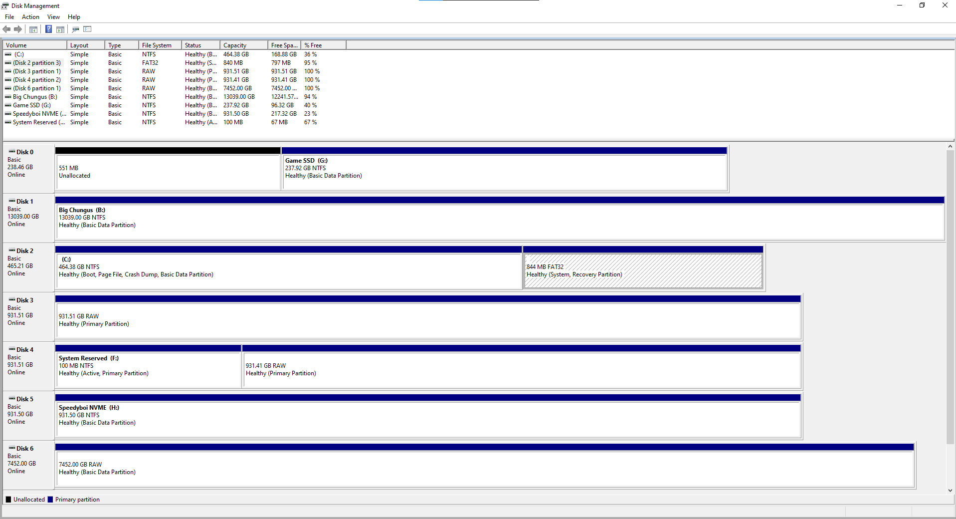

Well, I know you have no extra partitions on Disk 0 that holds your Windows...
So, delete those three (at the "where do you want to install Windows" screen. Then select the unallocated space, & click "next".
(g) I know you've got a Legacy install. It's best to do a UEFI install for added security & the benefits of a GPT (not MBR) hard drive partitioning style. To do that, BIOS must be set for UEFI mode. (If the computer is capable of it, it must have come that way from the factory. But yours is set for Legacy now.) In addition, you must choose to boot the Installation USB drive from the UEFI option (if more than one is offered) from the BIOS Boot menu screen.
If you do that -- & you have nothing but unallocated space -- then the drive will be automatically reformatted to the GPT style (which is necessary to UEFI). Otherwise, it will remain in the MBR style.
