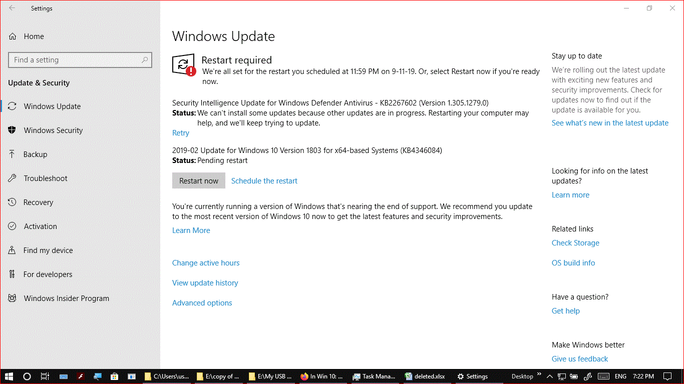

I remember now that the offered update came after only about a day of the suspicious update. Normally it's every month. The offered one is:
Quality update 2019-02 Update for Windows 10 Version 1803 for x64-based Systems (KB4346084)
You're currently running a version of Windows that's nearing the end of support.
It comes with a red exclamation mark saying Restart required.
