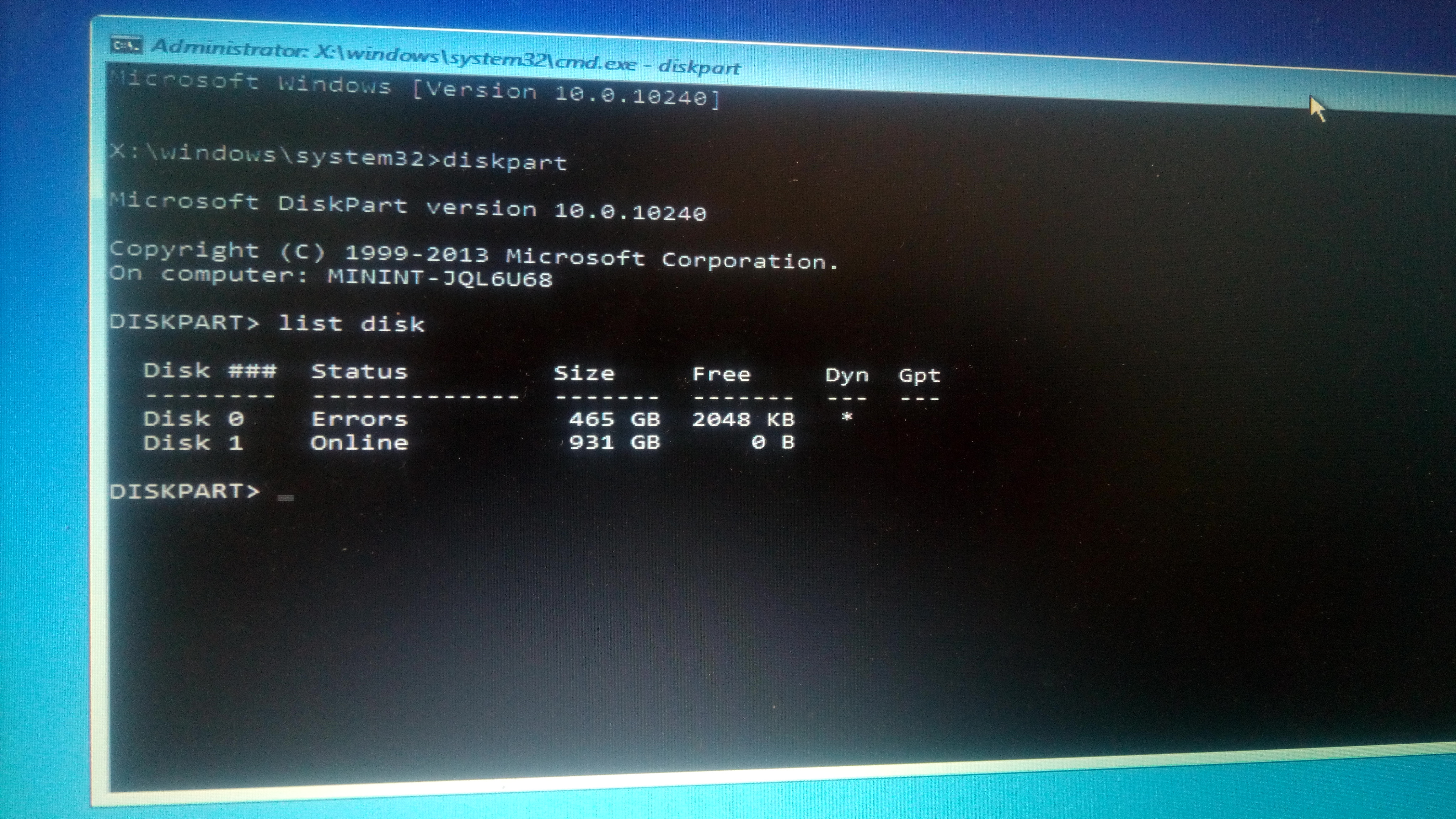

    I installed a clean windows in my pc and my files are too safe , i didn't loss them . After then I ran chkdsk command then it successfully checked it and then I repair my drive then it completed successfully and then the disk error was appearing again and again even I reactivate the disk .
    I reactive the disk then the error status disappear then again it shows up and then again and again . I don't know why but my disk was repaired as it was shown and then I scanned my drive in properties>tools>chech now
    Then it was completed successfully and found no problem but I don't know whether my PC is fully fixed or not but till I typing this message the error status isn't showing .

    Your hard drive has experienced hardware failure or some irreversible corruption. It is also possible that the system’s disk configuration database might be corrupted. As I have pointed out earlier, you should consider replacing your HDD but first, take the drive to a PC hardware Technician to run complete diagnostics on it to ascertain the health of your HDD.

    What's the matter my dynamic disk is showing error status , Is there any clue of these things ?
