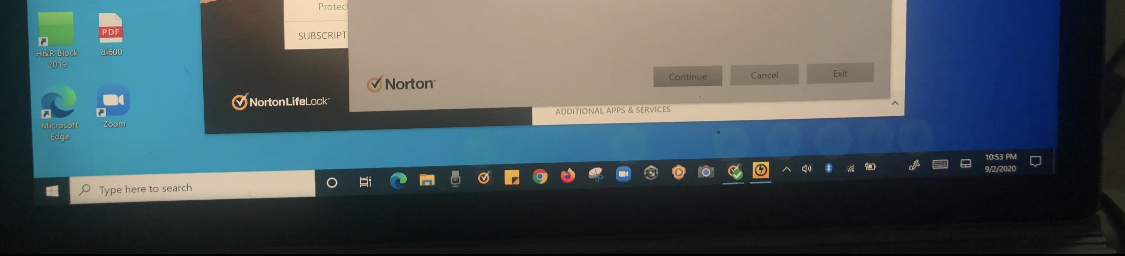

    2020-09-04T20:12:08+00:00
    I have the same issue this week 9.1.2020. I thought it may be caused by a virus or hack remotely. I used Norton Antivirus to scan. The results came out nothing. I recovered the Surface Book back to factory setup and it still have the same issue.
    After, I saw @jimclay57051’s post, I disable the bottom of the Human Interface Device - HID-compliant touch screen, it still have the same issue. Then I disable the top one and it finally stop.
    The downside to this temporary fix is, you cannot use your hand on the touch screen anymore.
