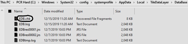

I was having this same issue. Here's what I did to fix it (based upon some other replies in this thread):
Open a CMD shell as Administrator.
That started me off in c:\Windows\system32.
cd config\systemprofile\AppData\Local
mkdir TileDataLayer
cd TileDataLayer
mkdir Database
Since then I haven't seen the error message in the event viewer.
