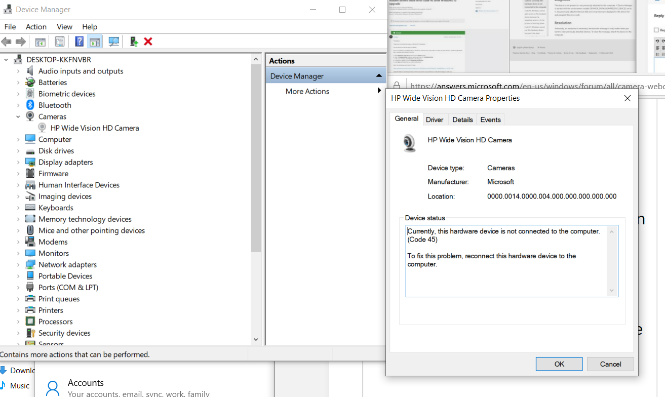

    Having VERY similar issue on same laptop... HP Envy Windows 10.
    I installed Skype on the laptop, and while it was installing, I think that's when I disconnected the WebCam.  I already tried restoring it back to the day prior to downloading Skype.
    Error Messages Below:
    My issue/error message is saying that my device (name: HP Wide Vision HD Camera) ) is "disconnected" to the computer (Code 45).
    1st screen shot:  Device Manager>Properties>"General" Tab
    2nd screen shot:  Selecting "Camera" from the Windows Start Up Menu bar
