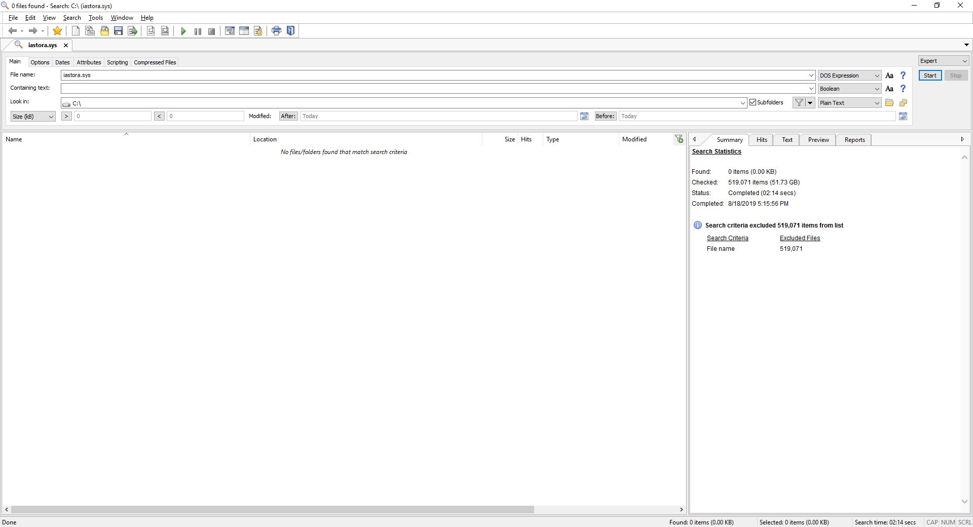

I did a search of my entire C: drive for a file named iastora.sys and it does not exist.

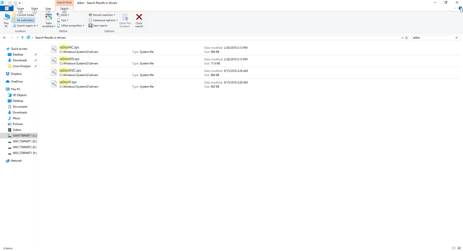

This is a search for Iastor in the \Windows\System32\drivers folder:

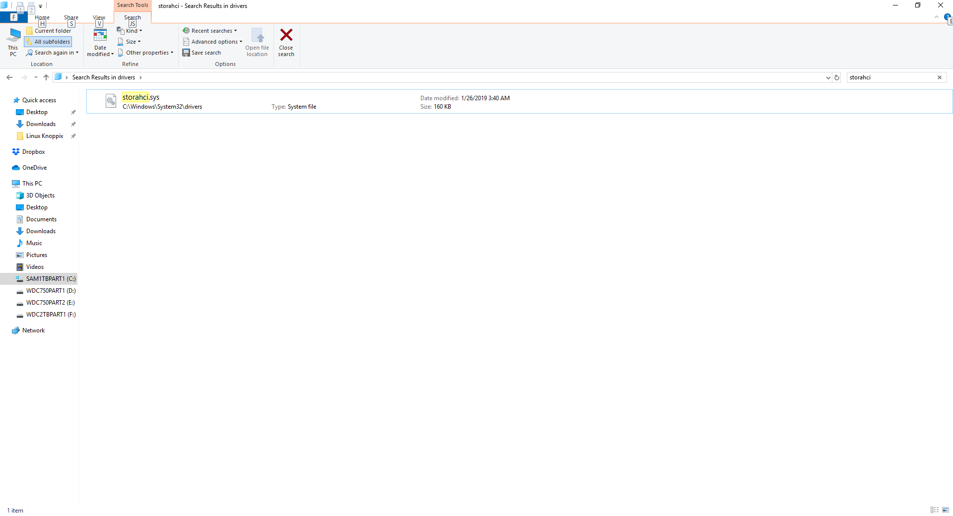

This is a search for storahci to list the file date if that is helpful:

However, the file that is blocking the Windows update, iasota.sys, is the old version that was present before I updated RST (note that other iasot*.sys files are newer):
