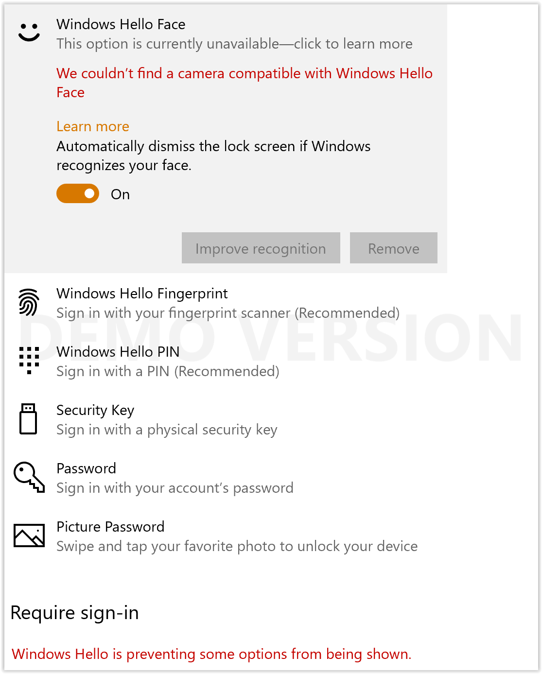

Hey,
a couple of days ago my Windows Hello compatible camera stopped working all of a sudden. On the Windows lock screen I see a message "Sorry, something went wrong. Please login with your PIN" and in the Sign-in options in settings I see "We couldn't find a camera compatible with Windows Hello". I didn't install any Windows Update right before that happened and I also didn't install any tools or updated drivers or anything. It really happened all of a sudden. It worked on one log-in attempt and did no longer after another log-in attempt.
The camera itself is okay. I re-installed the SSD that came with my PC with a (nearly) straight from the factory Windows and the camera works perfectly fine there, so I'm pretty sure it's not a hardware problem here. My computer is an ASUS Zenbook Pro 14.
I'm running Windows 10 with the 1903 Update, Build 18362.267 and as I mentioned, it just stopped working all of a sudden. I'm pretty sure I haven't installed any software or drivers or updates right before it stopped working (I might be wrong though).
I cannot even remove the Windows Hello Face Recognition because the button is disabled (see screenshot below).
Long story short: my Windows Hello compatible webcam is no longer recognized as such and I have no idea why. Appreciate any tips!
// edit: I already uninstalled the camera driver in the device manager and I also tried to install newer drivers using Driver Easy, both without success.
// edit 2: I also tried “Sfc /scannow” and "dism /online /cleanup-image /restorehealth" now. Everything seems to be fine. Except ... it's not.

I got it working again, yes! I don't know if this was how I fixed it, but I'm almost sure. I had two files HelloFace.inf and HelloFaceMigration.inf in C:\Windows\System32\WinBioPlugIns\FaceDriver. I right clicked them, selected "Install", restarted and now it's working again!

    Manuel, you are a genius! Your fix led me through Hello setup again, and facial recognition worked! Keep up the good work!
    2020-01-05T14:55:06+00:00
    This worked for me as well.
