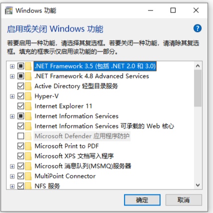

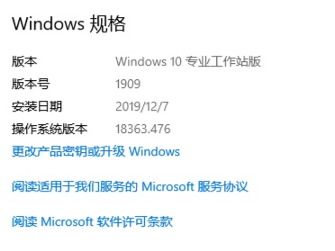

    I found that it's still an issue on build 18363.476 (screenshots are in Chinese, but they are similar).
    I tried all the methods in this post and somewhere else, in Chinese and English communities, all those command lines, but none of them seem to work.

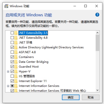

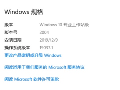

    Finally I read about that update to the latest Insider Preview may solve the problem, so I just joined the Insider Preview and update to 19037.1, and solve the problem.
    Since this is my personal PC, and there's nothing important in it, I can accept to use the Insider Preview version.
