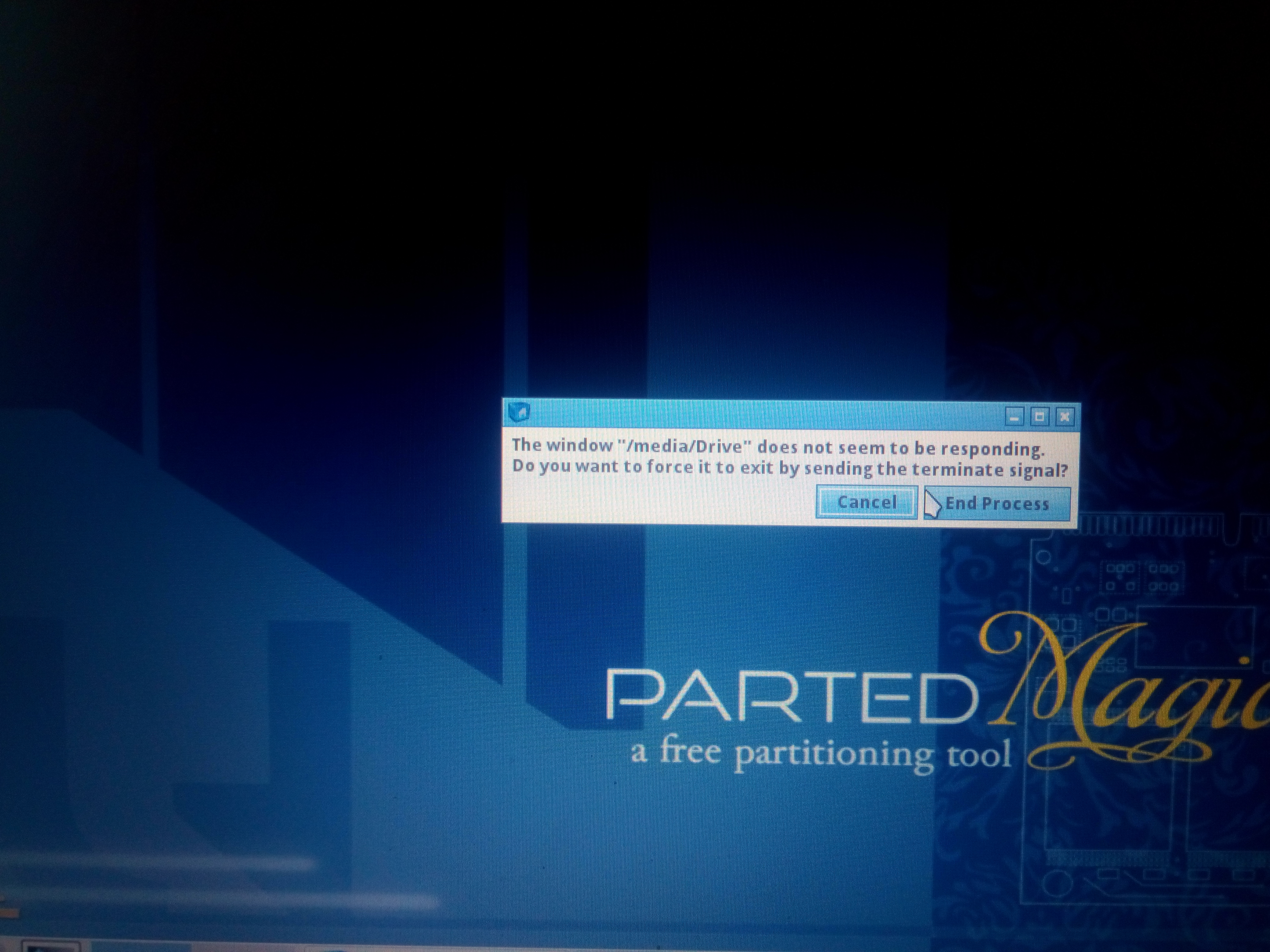

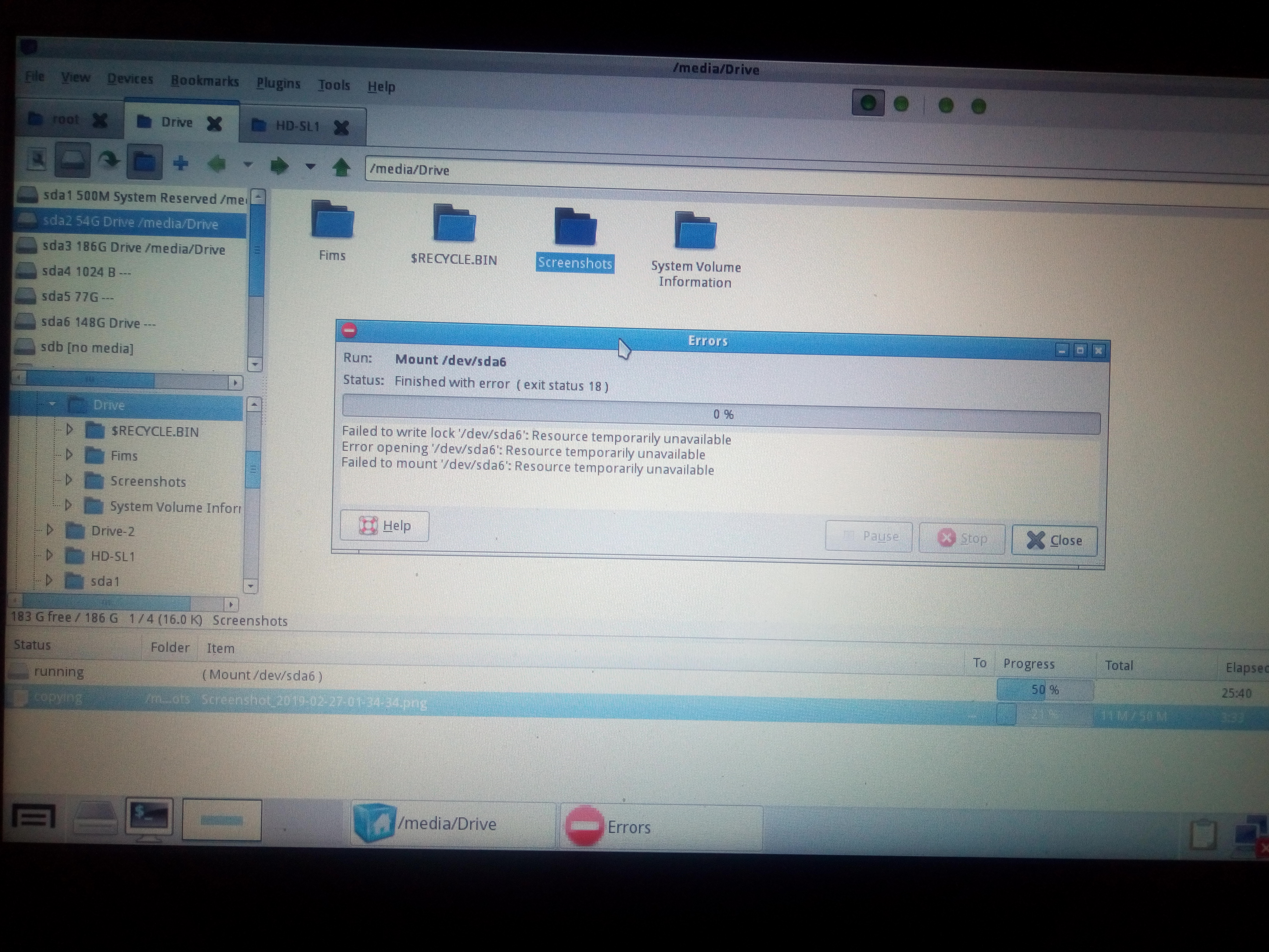

    2019-03-29T17:47:06+00:00
    Do you have another external drive of any type to copy to... even a flash drive ?
    Just to test which drive is having the problem...
    Parted Magic does mention failing to mount the internal drive\partition though...
    Do all of the partitions do this when you try to copy, or just some ?
    Did you check all of the partitions with chkdsk /f ? I have had problems in the past where it took several tries with chkdsk to get things to work better...

    2019-03-29T12:37:51+00:00
    It seems like you are having a failure of your HDD... But it is possible that a improper shutdown may have caused a problem also...
    I'm not 100% sure if the errors are from the drive you are trying to copy or the drive you are copying to... Most likely the one you are copying...
    One thing you might try is to boot with installation media and try the command prompt to run a CheckDisk command and see if the drive or some of the partitions may be fixable...
    You would need to do this for every partition separately... You could just start with C: and then continue with all letters until you cover your partitions...
    This is the command....   chkdsk c: /f

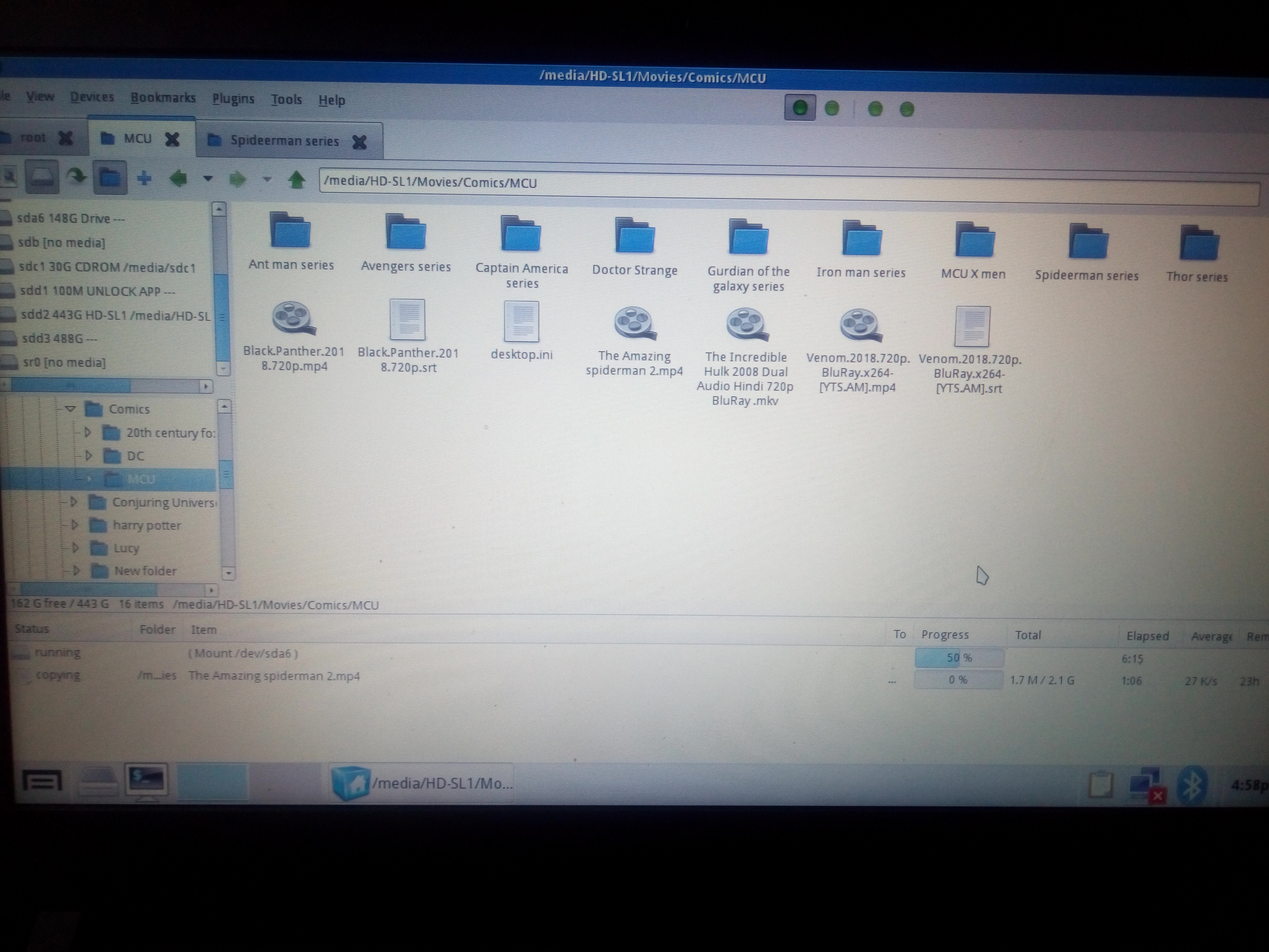

    2019-03-29T11:42:01+00:00
    I boot it successfully and now I am transferring my files but see how the speed is running .
    And my windows is getting too slow , and it's saying not responding .
    Why such a message appears and why it's transferetratoo slow , previously in windows 7 it was showing the speed 0 bytes/s but here the speed is 27 kb/s .
    And when iam trying to open a certain drive it showing like in the picture below
