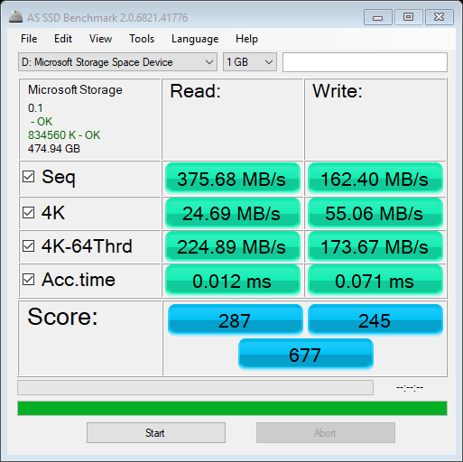

    Yes, the install on my hard drive had to be in legacy mode from what I remember. I believe I actually had the issue where it defaulted to uefi but it wouldn't work with my drive. Using the legacy installer fixed that. This drive I tried to install in legacy mode as well the first time. The install media will run but I got an error saying the drive isn't compatible. So that's when I tried the uefi disk which worked until it has to restart. That's correct though. When I wipe the drive with the uefi device and install, it formats it to GPT. I tried checking the drive using CrystalDiskInfo it seems to be okay. AS SSD Benchmark gives me this
