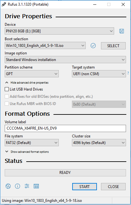

    You might try downloading a ISO instead of creating a flash drive with the Create Media Tool, and then burn the ISO to the flash drive with a free tool called RUFUS...
    It must be specifically created for "GPT" and UEFI Bios, as well as being FAT32 file format..
    If any of these are not correct, it can be a problem..
    Here is what your RUFUS screen should look like... The USB drive and Image name will be different, but the settings are what you need...
