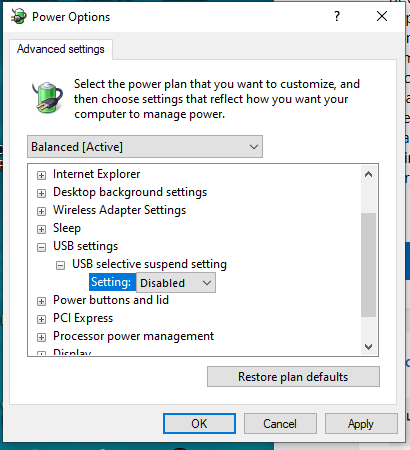

The behavior may change in different machines and with USB hub drivers, but some reports suggested to disable USB Selective suspend setting in control panel power option. May be even the case when you download both 32 and 64 bits because the process takes much longer before MCT tries to use the USB device, if USB goes into selective suspend it may fail accessing it when needed.
I don't have the problem in my machines, but it has been reported by some users.
You get the same error if you remove the USB device after MCT has initially found it and started the download, MCT only checks again after the files are downloaded and verified and it needs to format the USB device and copy the files over, the longer the process takes the more chances you have to enter USB Selective Suspend.
On a desktop I see only one option.On a Laptop I see 2 options for :
