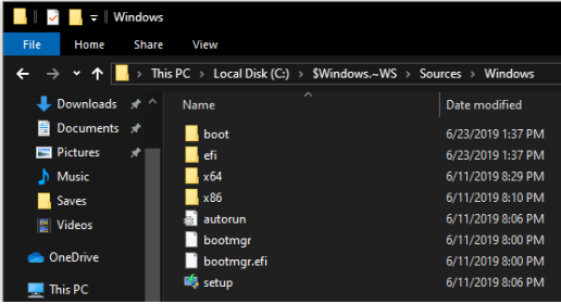

    Tough this shouldn't be needed and it's not for the novice, what I did has never failed me and you don't need Rufus.
    After the tool errors, leave the error up. Try to open the USB drive. Windows will prompt you to format it. Do this. Open your root drive (C-drive?). Find the folder in the address of the screen shot I posted and copy everything to your USB drive.
    After you're finished, closing the error will delete the folder off your root drive and you'll have to run the tool and have it download the files all over again.
