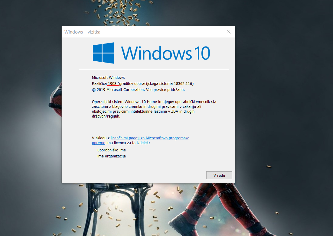

    Thanks MonikaPetek. For all the suggestion and moral support! I just tried the assistant again with just the mouse on bluetooth and the second time it downloaded and installed 1903 ! It recognized the USB drive and SD card when I attached them. This has been a very helpful thread.
    Also noticed an improvement with edge not freezing and working like it should :)

    2019-05-23T15:02:34+00:00
    Hi Gordo,
    I installed today 1903 version. Smooth, without any errors, nothing actually. No problems with apps or any other files. So I hope, you can install it soon.
