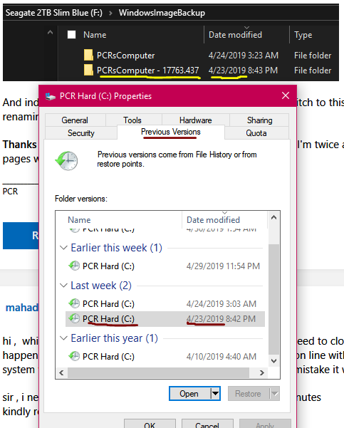

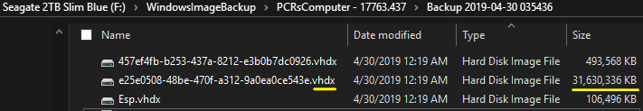

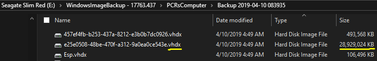

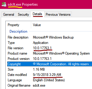

BTW... You mentioned System Restore not working as well as before, and I mentioned Acronis...
Acronis is nice to have, but Windows also has a built-in Imaging feature...
It is no longer supported, but works on most machines... especially those using Legacy Bios as ours do... You will need bootable Installation|Repair media to reload an image though...
The Imaging tool will ask if you want to create a CD when it completes, or you can use installation media's Repair feature...
The tool basically takes a snapshot of your OS drive... Then reloads it if you should need it...
You can find it in Control Panel... It's called "Backup and Restore Windows 7"...
You can save the image to most any drive you choose...

    I only speculate, but could be, as GPT came in, the MBR format is kept & handled for compatibility reasons only. Every fix or improvement to Windows system image backup & restore could mean trouble for MBR. The date on SDCLT.exe in 1809 is 9/15/2018.
    I think your experimenting has put joy into UEFI people like me. but spells doom for those who are Legacy. What is happening with imaging could be happening to other important apps & processes as well. I haven't had a severe issue with Windows Update yet, & only one feature update came in a little rough. I'm looking forward to 1903.
    But I did get two more surprises even in my UEFI install. I put an incremental into "WindowsImageBackup - 17763.437" & couldn't believe my eyes. So I put one into "WindowsImageBackup - 17763.379" & couldn't believe them again. Those are originals on Slim Red, not copies. This was the first incremental either had seen, going by my customary practice & the fact their LOGS folder had only one file in it & now has two.
    Restore showed this for ...379 at Screen 3...
    5/02/2019 05:22:17 PM  EFI System Partition, C:, Volume(457ef4fb-b253-437a-8212-e3b067dc0926
    3/12/2017 07:12:47 PM  EFI System Partition, C:, Volume(457ef4fb-b253-437a-8212-e3b067dc0926
    Just like yours - both have a C:. I'd have declared victory - but here is ...437 at Screen 3...
    5/02/2019 11:01:18 PM  EFI System Partition, C:, Volume(457ef4fb-b253-437a-8212-e3b067dc0926
    5/01/2019 11:01:18 PM  EFI System Partition, C:, Volume(457ef4fb-b253-437a-8212-e3b067dc0926
    4/29/2019 07:54:36 PM  EFI System Partition, C:, Volume(457ef4fb-b253-437a-8212-e3b067dc0926
    4/23/2019 04:42:31 PM  EFI System Partition, Volume(457ef4fb-b253-437a-8212-e3b067dc0926
    4/10/2019 07:54:36 PM  EFI System Partition, C:, Volume(457ef4fb-b253-437a-8212-e3b067dc0926
    So one incremental put 5 entries there. Definitely it had only one when I looked yesterday. (I wish I had looked again just before making this increment.) All of them have a C: except for one. The 3 middle ones are the same as on the copy of ...437 I posted yesterday. But that's on a separate HDD. The bottom one must be the original entry, & the top one is the increment I just made. I say, like you, that it includes the original. I went back & looked at the copy, & it still has just its 3 lines.
    If it weren't for the 3 lines that match the copy, it would be like yours & ...379's. I think I'm going to give it all up, though, & declare everything is fine with Windows system image backup & restore. I think I'm getting an evil effect from having made an incremental into a copy. Someday should I decide to do another clean install, maybe just before it I'll try to restore that one on my copy that has no C: & see what happens.
    "I don' think copying the Image would be a problem, but I did encounter a problem with that...
    In order to use the copy, I had to copy it back to it's original location..."
    Hmm. Maybe, had I moved the copy back to the drive it came from before doing the incremental, every line would have a C:. I do know, the last words of the imaging process are that it is making a shadow copy onto the drive that gets the image. Let me try this first. This one was made into the folder after the move to Slim Blue...
    It has one line & with a C:. I'll put an incremental into that & see what happens.
    Edit: The incremental took 7 minutes to make. The result, 2 lines now, each with a C:...
    5/02/2019 10:16:55 PM EFI System Partition, C:, Volume(457ef4fb-b253-437a-8212-e3b067dc0926
    4/29/2019 09:53:58 PM EFI System Partition, C:, Volume(457ef4fb-b253-437a-8212-e3b067dc0926
    I think that proves it. But, fine, I'll copy that one over to Slim Red. And I will expect a 2nd incremental into it to look bad. If so - in UEFI anyway - it's best to move the copy back to its original drive before use. But I hope a crash or loss of that drive wasn't the reason to go for the copy in the first place. I'll edit the answer into here.
    Edit: It was bad. Bottom line: Don't make a copy of WindowsImageBackup. Slance310 says it won't restore unless it is moved back to the drive it came from first. And I say you can't make an increment into it. If you want a copy of it (which I never do anyway)
    • make a duplicate original. The end.
    Final edit: So what had happened was...
    (a) I made an image onto Slim Blue. It got its C:  at restore's Screen 3.
    (b) I put an incremental into it. Two lines, now, each with a  C:.
    (c) I copied it to Slim Red. It went back to just 1 line at Screen 3, but at least it had a C:.
    (d) I put a 2nd incremental into it. **Still there was just one line, at least still with a C:,**yet there were
    **** 3 files in the LOGS folder (meaning 2 incrementals were done.
    But that's enough for me. I am really, really done with it.
