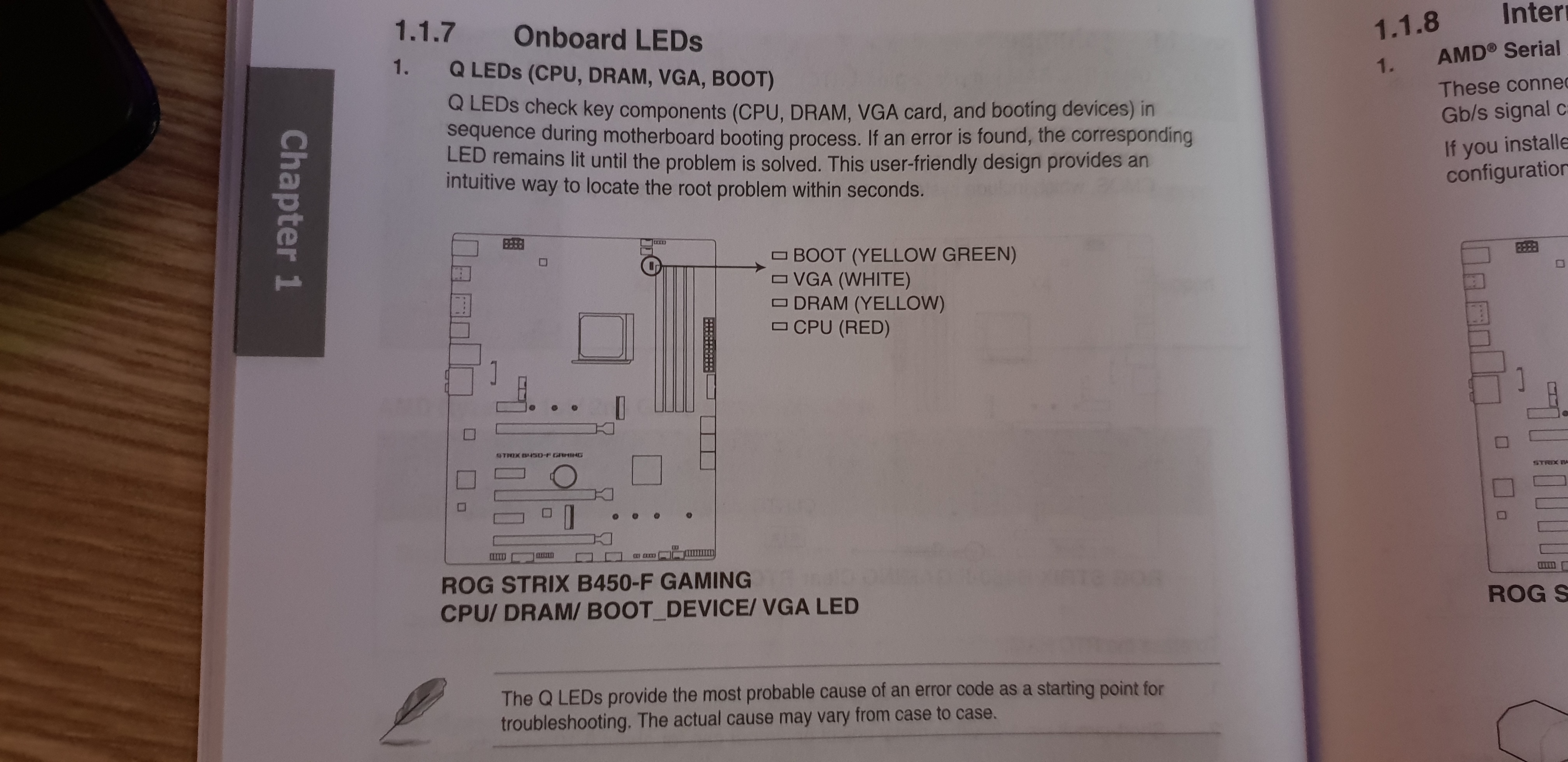

    It worked great 2 hours ago
    And it have leds to show whats bad but non off them light up whe its on boot logo

    I don’t want to pass the buck, but I think giving the place you purchased the PC from a shout is your best option. If you can, find the hardware diagnostics and take a pic of that, as they may ask to see it. (Or, if they are like HP, they’ll have you do troubleshooting via the phone to prove it’s dead)
    2018-11-29T11:06:55+00:00
    With everything you’re telling me, it absolutely feels like a hardware issue. I was hoping you could run the hardware diagnostics if you had any... but I think you’re on the right path. If it’s freezing outside the OS (Ex. Booting to media) it’s probably a piece of hardware. Bad ram, motherboard, or yes, the SSD.
