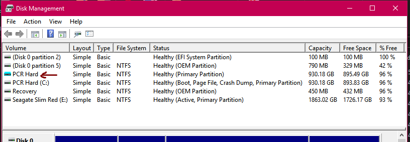

2018-11-16T07:27:21+00:00 (1) I meant to ask the size of your Windows partition (C:) not the folder. But it's probably OK.
(2) Too bad that "error" log is empty for you too.
(3) I do not see that you have a Recovery Tools partition. (At least, Backup & Restore did not make an image of it.) Have you got a file named WinRE.wim, likely in a folder named C:\Windows\System32\Recovery? If so, that is your Recovery Environment which will load when you Shift+Restart. Otherwise, you don't have one. Better make a Recovery USB (ask Cortana for Recovery Drive).
(4) Your backup log indicates your EFI partition (if yours is a UEFI install) & your Windows partition were successfully backed up. Do you know how to take System Image Recovery to the brink just to see whether it is offered for restore?

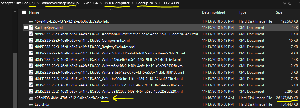

(5) Here is how to mount the image of C:.
(a) Open the WindowsImageBackup folder on the external HDD that holds it.
(b) Get to the Backup folder with the proper date.
(c) Double-click the largest .vhdx in that folder. That will likely be the C: partition.
It might mount & open in a new File Explorer window at that point. But...
(d) If you get an error message, click "OK"...
(e) Right-click START, & select Disk Management.
You will see it has mounted, but without a letter...
(f) Right-click the one that has no letter, & select "Change drive letter & Paths", then click "Add". Either "OK" the one offered, or select your own. Disk Management will now show a letter...
(g) You may now open the mounted image in File Explorer. Look good?
(h) When done, right-click the drive in File Explorer, & select "Eject".
I find that, after going through the error once, the next time the .vhdx will just mount & open.
