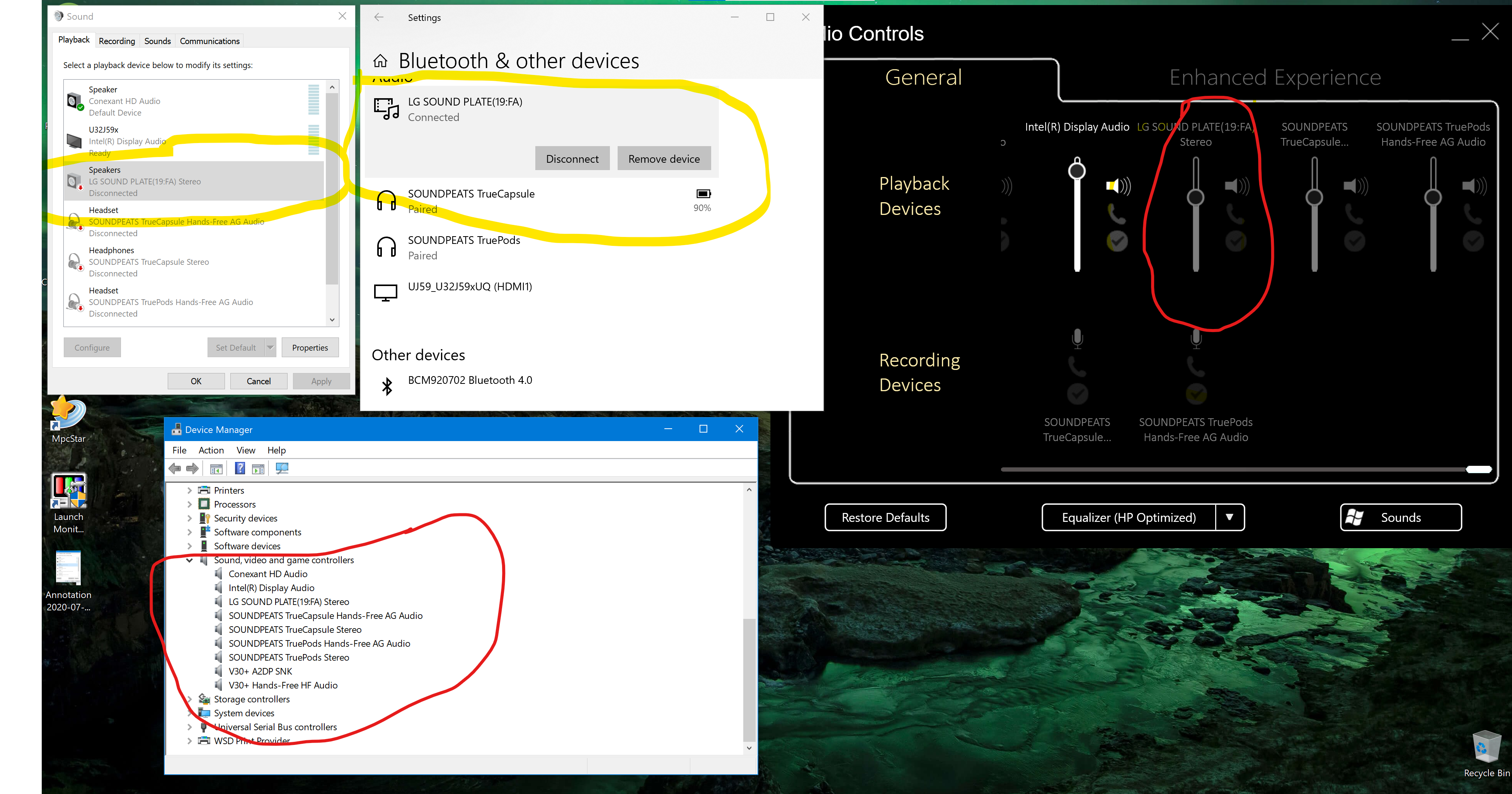

    2020-07-18T19:57:28+00:00
    I used a LAP240 soundplate. Same results man.drivers installed(supposedly) and in the enhanced soundbar its greyed out. in the SOUNDS it's greyed and "disconnected". I did have this same soundbar working with a windows 10 laptop. the laptop was an ASUS. I'm going to say in 2018. I streamed some music from the laptop to the plate. I don't know what version of windows 10 that was. But it did work. It was my brothers laptop and i never thought nothing of it till now. What's going on Microsoft. It just seems crazy.
