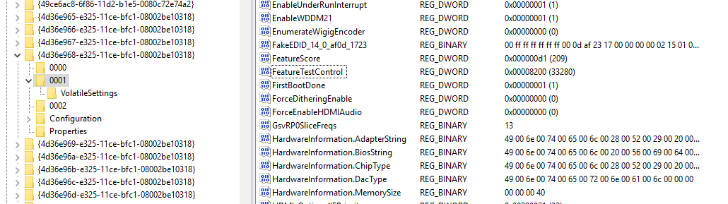

    Please try 0001 instead of 0000
    Computer\HKEY_LOCAL_MACHINE\SYSTEM\ControlSet001\Control\Class{4d36e968-e325-11ce-bfc1-08002be10318}*0001* \FeatureTestControl
    Ok. I see you have 6th gen Intel HD... I am looking for first gen Intel HD. I have another laptop with intel hd4000 and it works fine in v1803.

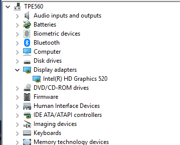

    Here is what I have on my Lenovo Edge E560

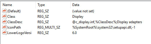

    I do not have FeatureTestControl under 0000
    Looking further,
