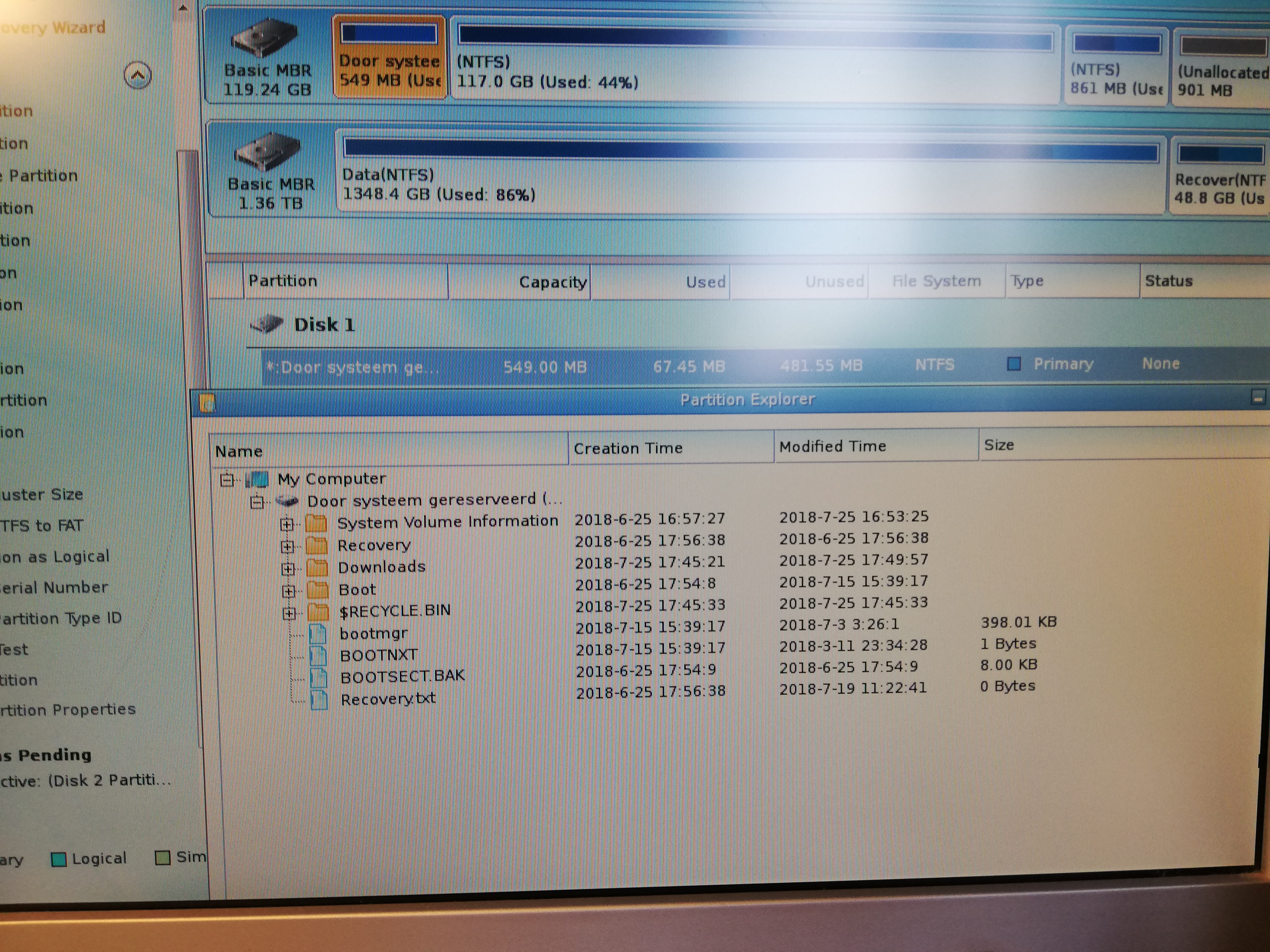

    2018-08-26T12:24:01+00:00
    The SSD has a partition "reserved by the system" of 549mb. Of this 67MB is used by those boot files. Status is None, shouldn't it be active/boot?
    2018-08-26T12:08:58+00:00
    Another try:
    Repaired PC with the USB drive. Didn't removed it yet.
    Reboot works, shutdown + boot works, shutdown works. Then I removed the repair USB drive, boot gives the no OS found error.. I shutdown again, put the repair USB drive in again, and the PC does boot to windows..
    Maybe there are files on the HDD the pc needs to boot?
    There is 1 data partition and 1 recovery (both NTFS). The data one has a folder zBoot (year 2012), System Volume Information (2011, modified 2018-6-29), Boot (2018-7-22, modified 7-24), file pagefile.sys (2018-4-3, modified 2018-6-25), bootmgr (2012-7-10, modified 2009-6-14), BOOTSECT.BAK (2012-7-10), Recovery.txt (2018-7-19, modified 7-23), WinPEpge.sys (2012-7-10).
