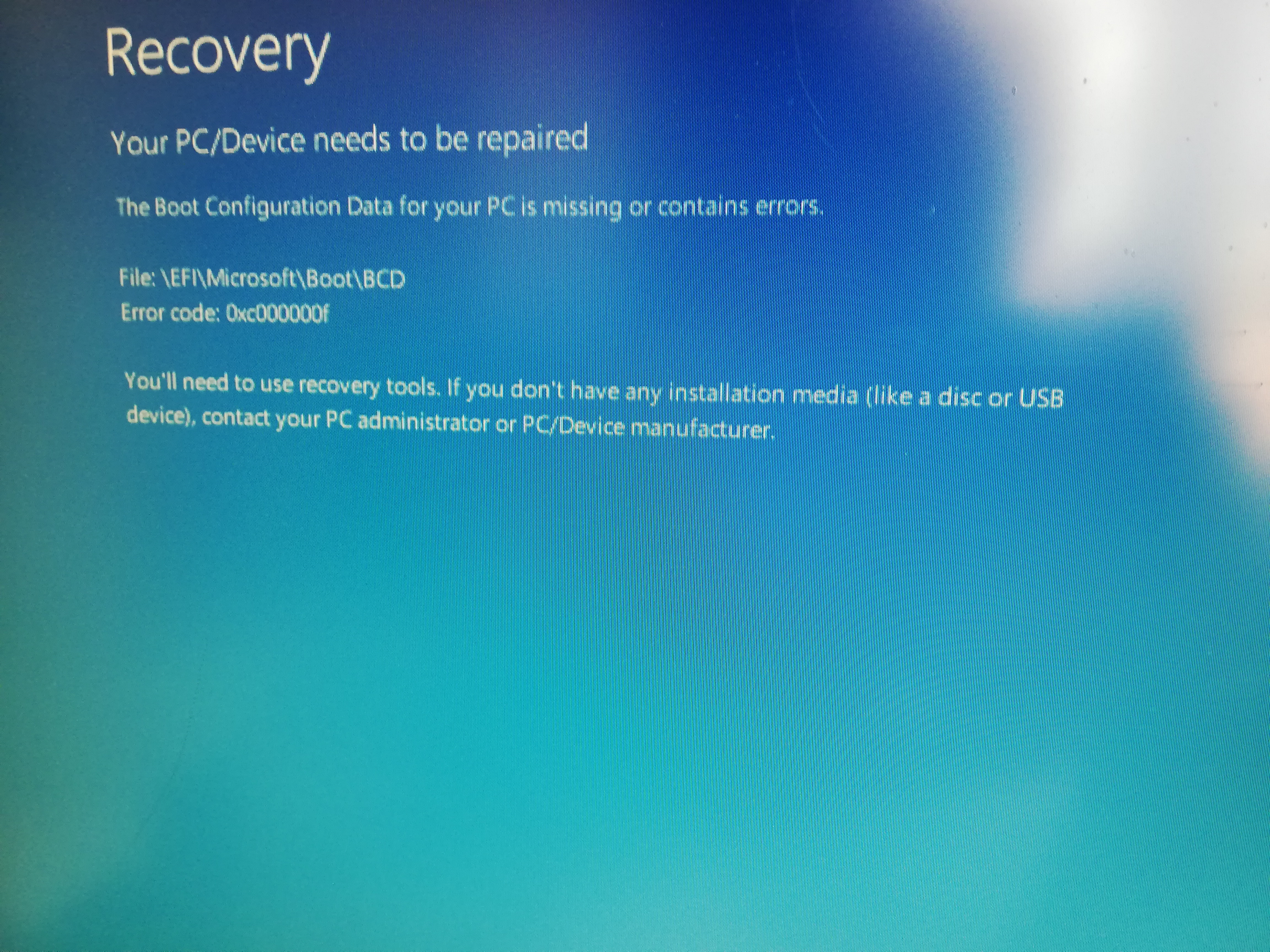

    When I make a repairstation from a windows laptop and boot it from UEFI, I get this error. It even has the EFI in the root, only 1 partition.
    When I boot the same drive through USB KEY, it gives the two errors at FIXBOOT and REBUILDBCD again.
    2018-08-24T10:23:01+00:00
    • The two BBS are also just priority, no settings.
    • UEFI: i Key and LaCie itsakey are both the same USB drive I used in the mediacreationtool for a bootable windows repair drive. I booted from both when trying to repair.
    • As expected, the legacy usb drive isn't bootable using UEFI.
    • I first see the manufacturer screen with F8 for boot priority and DEL for BIOS. Then Windows screen and then logon.
