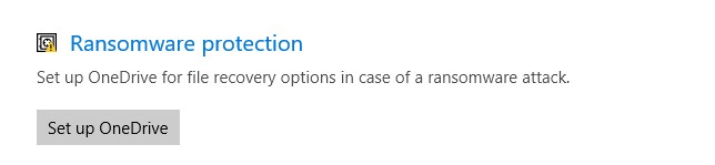

    I found my issue, maybe it will help others. Go into the security center / click on the Shield (left side) Virus and Threat Protection. Look for Ransomware protection. I had a message about setting up OneDrive for file recovery in case of a ransomware attack. I dismissed the alert.

    2018-08-14T23:31:51+00:00
    More info on why you might or might not want to set this up:
    https://www.theverge.com/2018/4/5/17201660/microsoft-onedrive-files-restore-feature-ransomware-protection
    thank you that fixed it for me.the only thing i had to do was turn on periodic scanning under windows defenders antivirus options and then dismissed the ransomware alert then turn periodic scan back off

    2018-08-16T15:12:03+00:00
    Thanks Outatimez, this worked for me. Maybe I was not able to see the warning on the Action Center because i had Windows Defender Periodic Scan off. After enabling it, I was able to see the Ransomware Protection warning.
