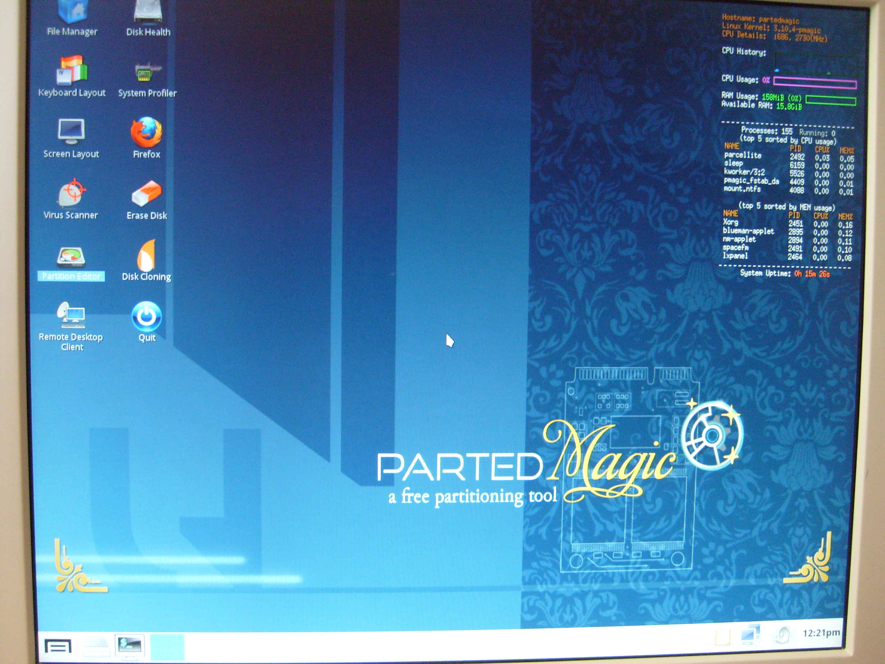

    I don't know what's going on with your machine, but I do not, and have never had, a second menu... It goes from the 1st menu to the Desktop on my machines... This is what I see...
    Have you tried hitting the key for BOOT OPTIONS at the POST screen and selecting "UEFI CD\DVD Drive" as opposed to simply "CD\DVD Drive" ?
    We could try a different program to try to recover your partition, but the other program does not have a File Explorer... It is just a bootable Disk Management program...

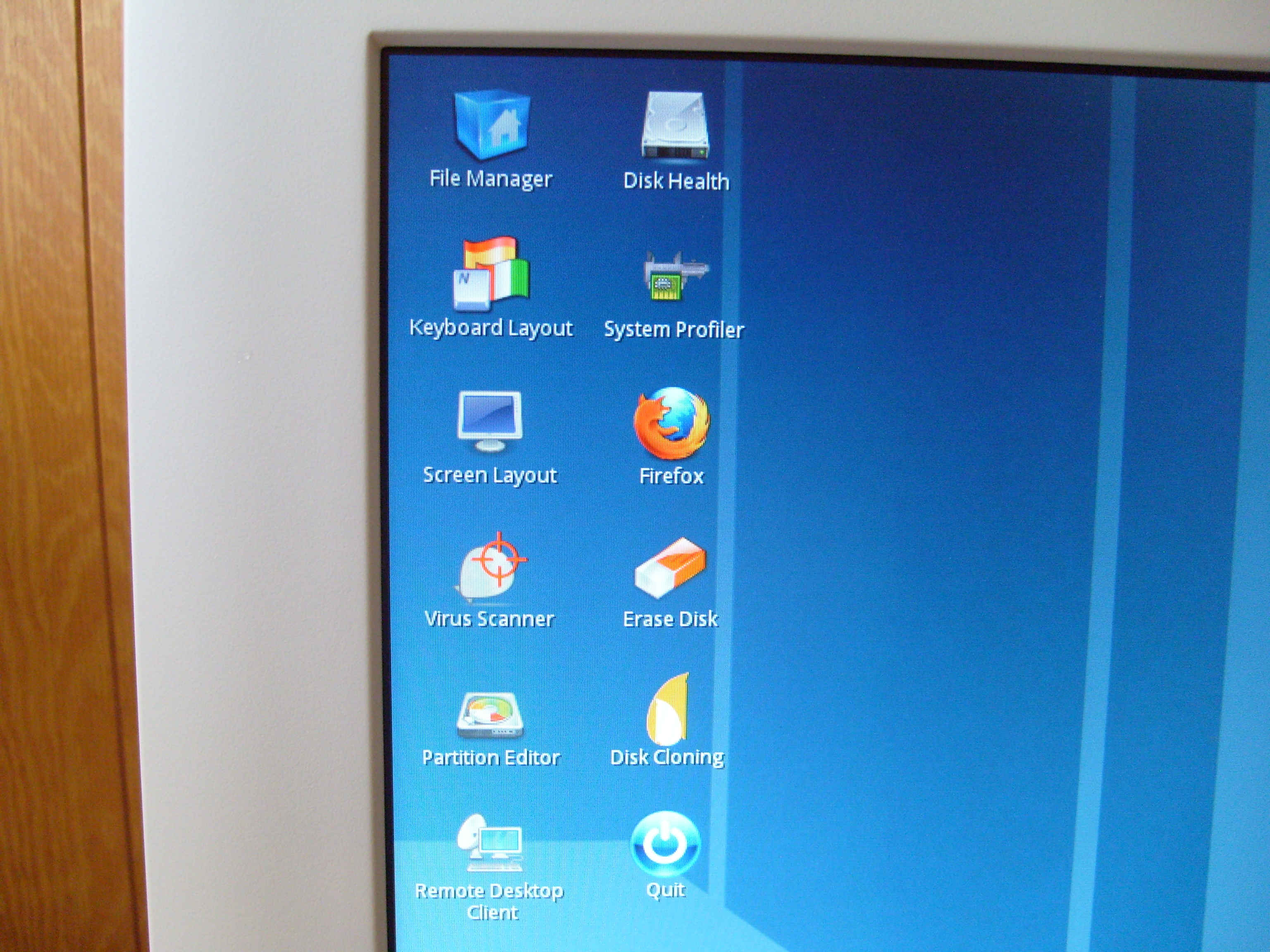

    2018-07-19T22:06:02+00:00
    When the machine boots, I get a rudimentary menu reminiscent of a BIOS menu.  The default choice (#1) takes me to another similar rudimentary menu (not a graphical desktop like you show in your last post), from which I can try to restore or repair a partition, but there are not options for file recovery.
    Back at the top level, there is a choice about halfway down for an "alternative graphical UI" (or words very close to those), but when I select that, I get a blank screen.  I let that sit for about five minutes before giving up and booting back to Windows.

    What does happen ? I thought you said you did a Scan and Repair using Parted Magic... This is what you should be seeing awhile after you see the menu for the 32bit and etc. stuff...

    2018-07-19T16:04:19+00:00
    Just like you mentioned doing when you found the drive had no partitions...
    Wait for it to automatically select the highlighted option (#1)….
    After a period of time the DVD will eject and shortly after the Desktop will appear...
    The first thing to appear will be a small window to verify the tome zone...
    You will the have a "Desktop" screen that looks like an older version of Windows... The file Explorer in on the upper left...
    I'm hoping that the File Explorer will be able to read stuff that has not been readable by other methods...
    If not, maybe the Data Recovery in the Partition Editor will find it...
