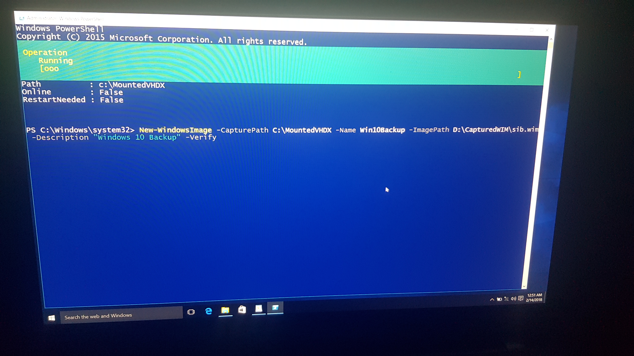

    Any ideas on why the sib.wim file would come out as 208bytes? Am I missing a tool? See OS below. Seems as if the process simply stops right after it starts. I sit and wait and PowerShell never completes the task. I tried making the sib.wim on my c drive and that didn't change things.  So, I ran the repair-windowsimage -scanhealth and everything checked out fine on the vhdx. After a lot of time poking around nothing seems to be a clear issue.
    Running Windows 10 Home
    Version 1709 <- ya I really need my image backup to work right now!
    OS Build 16299.125

    2018-02-13T15:37:55+00:00
    Ohh i got it now. Its copying the backup image to ext hard drive. ![](https://learn-attachment.microsoft.com/api/attachments/f73e388b-b6d3-458e-b585-311b17e4c48a?platform=QnA
    But its kinda taking very long.
    Finally i am able to restore my system image. Thank you

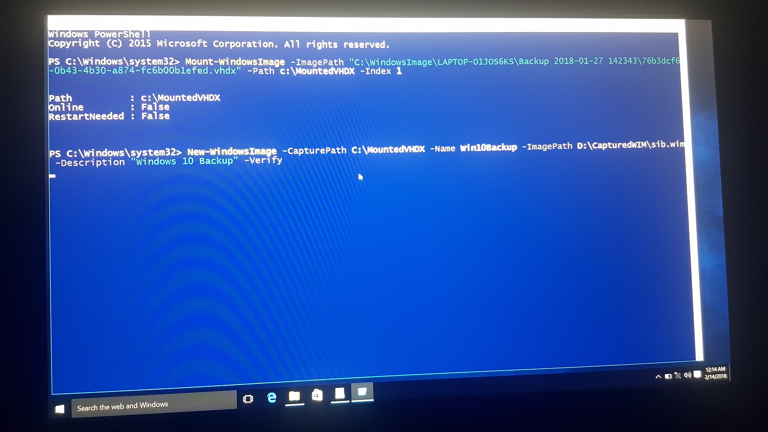

    2018-02-13T15:33:06+00:00
    Allright. But after executing 2nd powershell command , i am not able to execute 3 command. Does it mean something is going on at the background bcz i feel my external hard drive vibrating. So do i need to wait or somethings wrong?
