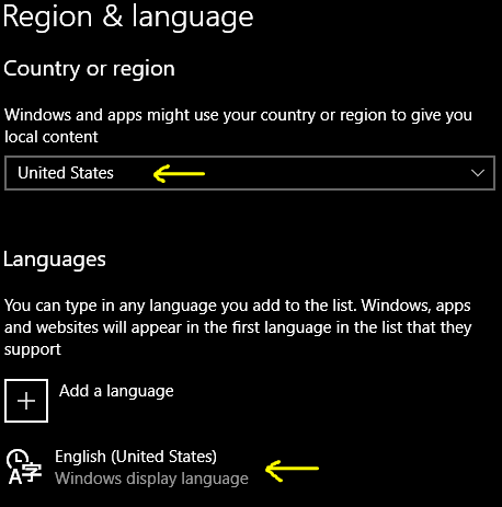

    1. Yes, time and settings is correct.

    (2) I see in the extracts that Robert posted of your logs that your computer appears to be "Locale = en-US". Please confirm that at "START, Settings, Time & Language, Region & Language"...
