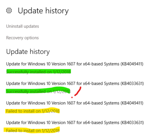

    Hi Roe:
    One other thing I did that I failed to mention in my previous post was to tick the Defer Upgrades box in the Advanced Settings for Windows Update.
    I then deleted the Windows 10 Update Assistant using the control panel.
    Following this - maybe a day or two later? - Windows version 1703 - called "Creators Update" - successfully installed.  At the time of my previous post I mistakenly thought that this was version 1709.  Once I realized that I had 1703 and not 1709, I went back and unticked the Defer Upgrades box.  Shortly thereafter, Windows version 1709 - the so-called "Fall Creators Update" - downloaded and installed.
    Windows update might be attempting to directly upgrade 1607 to 1709 which apparently won't work.  Ticking "Defer Upgrades" takes 1709 off the table, so 1703 is tried, which will install over 1607.  Once that's in place, 1709 should be installable which you can make happen by unticking the defer box once more.
    So if you have version 1607 at present, you might want to try the above.
    Hope the above works for you.
    wow.. i don't know what kind of crazy wizardry this is but you totally saved my sanity !
    was plagued with this problem for over a month !
    was ready to throw my computer onto the street.
    this windows update jam was a total headache.  computer would no longer sleep, it constantly tried to install that huge creators update which failed every single time.  every time i came to my computer screen i was greeted by the ridiculous installation failed windows assistant blue screen overlay.  then the entire process would start over again just eating through my bandwidth!
    tried your suggestion and it finally was able to complete the kb4033631 and kb4049411 updates
    after this, it was smooth sailing through the creator's update.
    i am sure there are thousands more struggling with this same issue.  it took me over a month to finally sit down and take the time to google this issue and i am so glad i came across your post !
    thank you DavidHankins1 !!!!!
    microsoft should pay you for this !  as they are clearly incompetent in finding a solution to this problem for every one !!!  their replies in every thread are trivial in nature as though they are reading from a complete script !
    i've attached a picture showing the dreaded updates finally succeeding after your suggestion of ticking the defer upgrades box.  thanks again!
