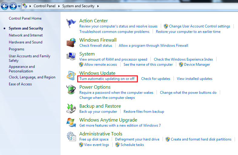

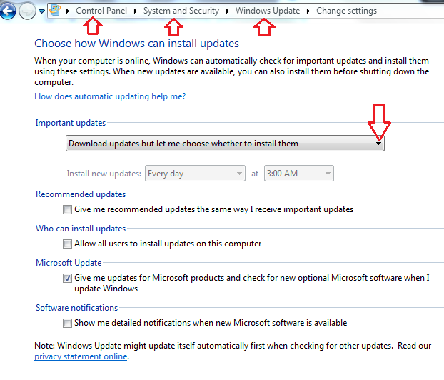

2018-01-07T16:34:43+00:00 On W7, it's easy to block updates by going to your Control Panel, System and Security, Windows Update, Turn automatic updating ON and OFF.
Then click the drop down menu and select other than automatically download and install.

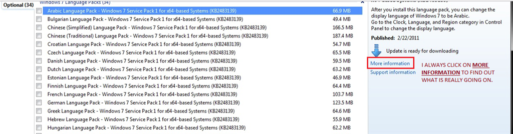

When available updates show up, you can right click and hide the ones you want to avoid and research the info on each one by highlighting one and clicking on more information.
