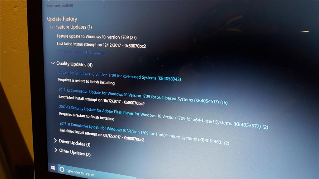

    My current situation.
    I think I'm on my 27th restart and counting.
