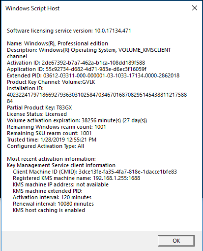

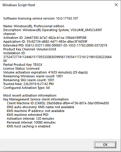

    2019-02-06T15:40:35+00:00
    This is what I get in mine

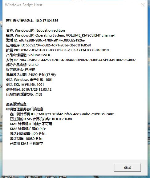

    2019-01-28T11:58:36+00:00
    Even I have the same problem. Could you please tell me the solution for this?
