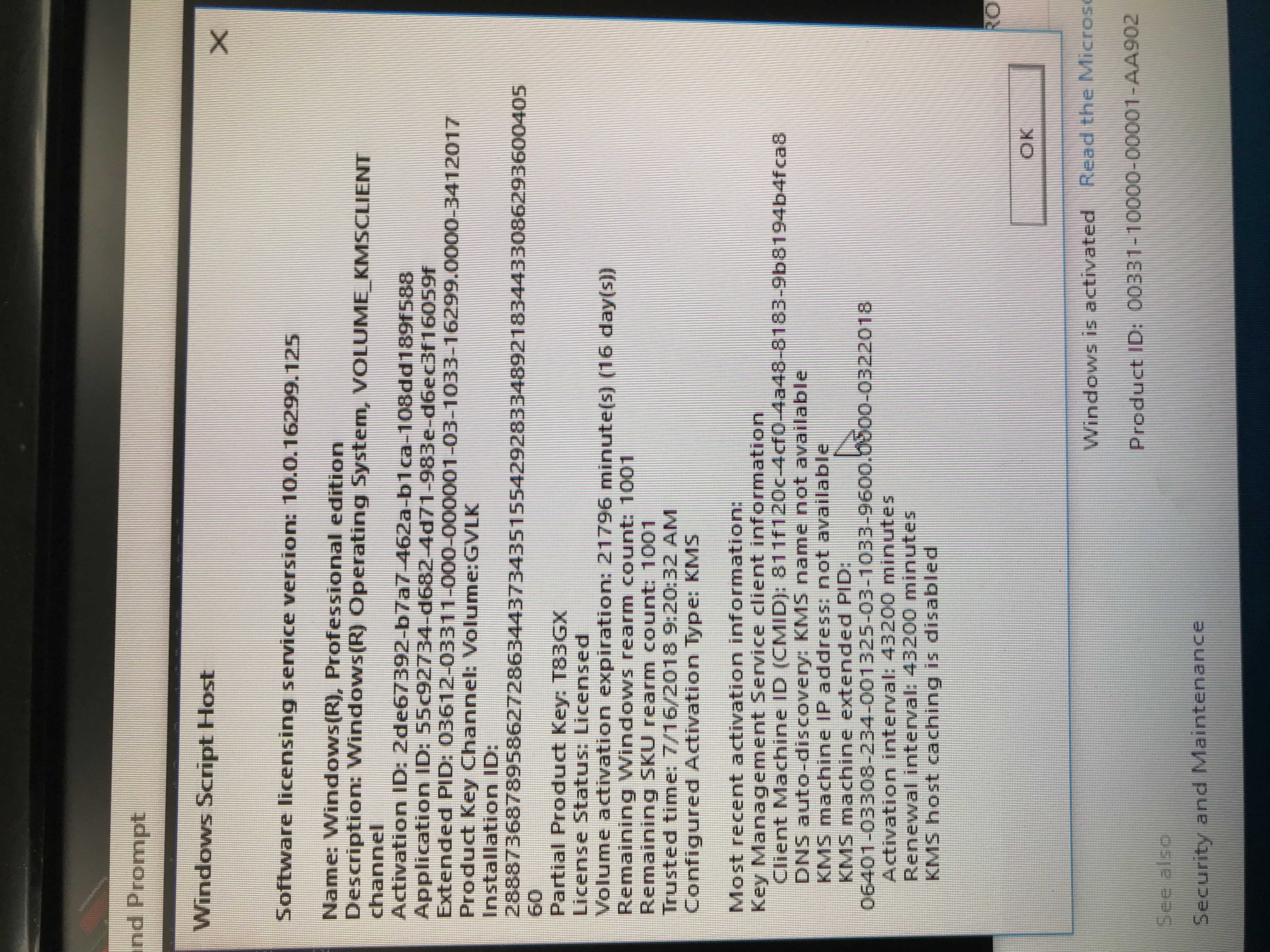

I'm currently using 'Windows 10 Pro' and my windows has been activated by my organisation's activation service. But i kept getting notification that my windows license will expire soon, it started happening after windows update.
I've tried using slmgr /upk and logging out of my microsoft account but none of that seems to work, I suspect that this is caused by the windows update because before the update I never get this notification.

    Yup, its a Windows 10 Pro Volume License KMS client. You need to purchase a genuine license.
    Whoever installed it, might have installed a volume license (organization key) on your computer.

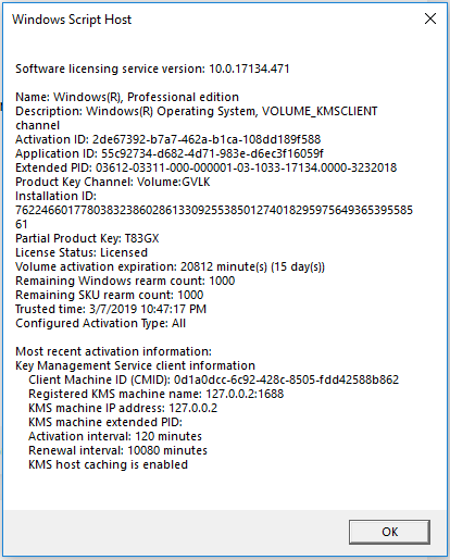

    Your computer has a volume license.
    "Description: Windows Operating System, VOLUME_KMSCLIENT channel"
    That type of license is sold to organizations that buy Windows licenses in bulk. In order to maintain its activation, a computer with that type of license has to be in regular communication with the organization's activation server.
    If your computer belongs to an organization, contact the organization's network administrator to determine why the computer is not contacting the organization's activation server.
    If you are an individual user you need to purchase a retail license for Windows 10 Home or Windows 10 Professional and do a clean install.
