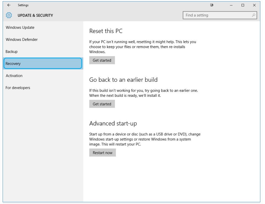

    If all else fails and you cannot get at least a one time boot, you can then do a windows RESET.
    I believe that refresh was only offered on (1507).
    After a reset you need only reinstall the programs that you were using.
    You would never have to start from scratch.
