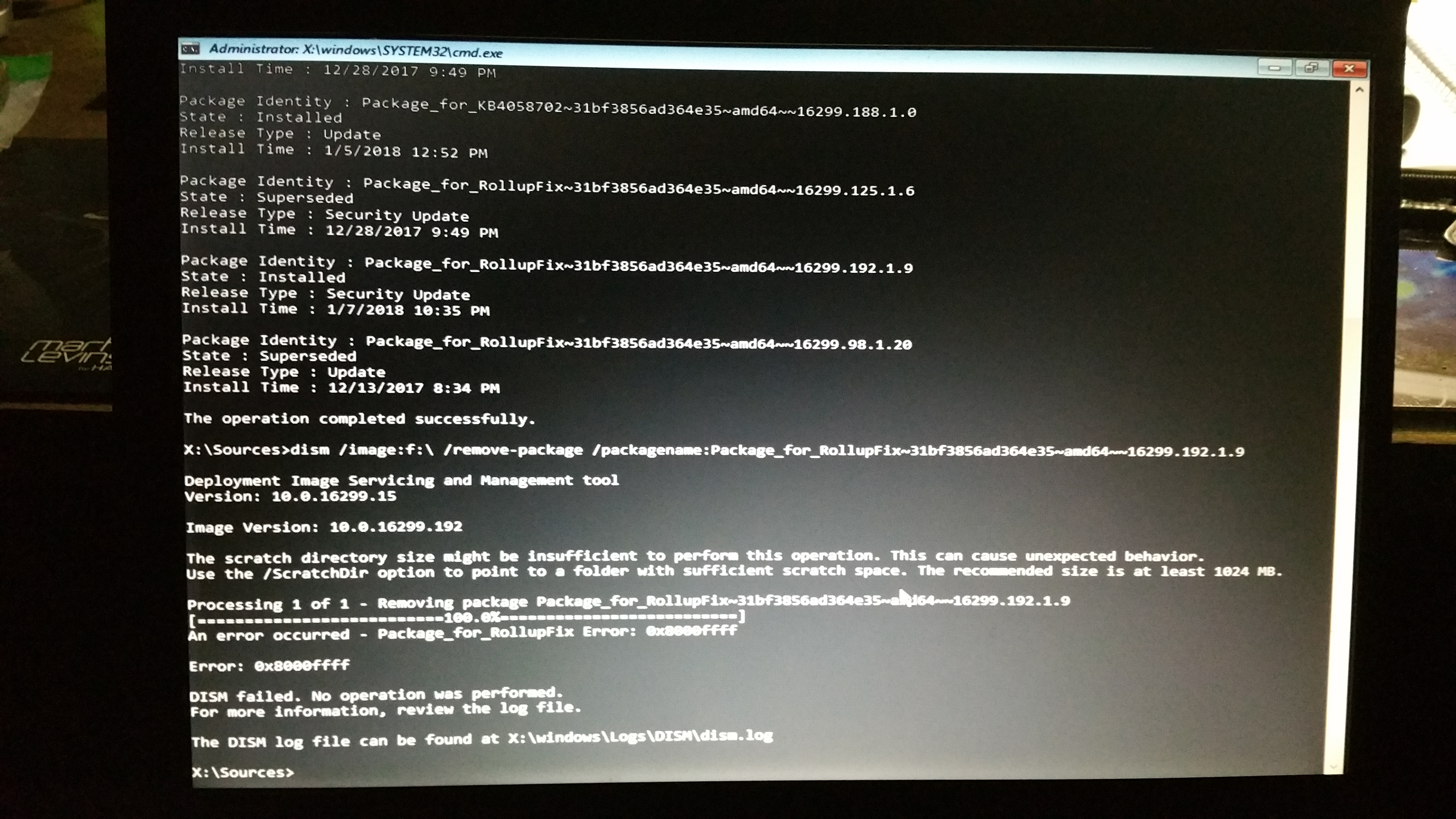

WIN 10 BSOD FIX - Inaccessible Boot Device - THIS WORKS!  I Just Repaired 2 computers that went down at the same time last night on 1/16/18
Good Afternoon Bobby,
Here is the fix I came across from another kind IT tech, please see below.  Credits go to them, I'm just forwarding so everyone can finally get their computers back up and running.
Boot Windows 10
Go to Repair
Go to Tools/Options to get a command prompt.
Confirm the drive letter for the Windows image. Usually D: –> dir d:
Run the following to view the installed packages which will also show a date of install.
Dism /Image:D:\ /Get-Packages
Find the package(s) that were just installed by date. Run the following command on the last installed package:
example: dism.exe /image:d:\ /remove-package /packagename:Package_for_KB4014329~31bf3856ad364e35~amd64~~10.0.1.0
Reboot.
The patch that caused my issue was from 1/6/18 or 1/10/18     Remove the latest windows update entry with Rollup Fix in it's name.  Once complete, close command prompt, turn off computer.  Power back up.  You should be back into WIN10.
If you still receive BSOD, rinse and repeat with the next latest update, try it again.  You'll eventually boot right back into WIN10.
I hope this helps.
Have a great day.
Showster

    There are no ways to dism off an update if it's pending install.  Sorry, Ira.

    2018-02-28T00:24:52+00:00
    I had the problem and removed all 2018 updates using dism in January.
    After that updates in February worked fine - no problems.
    Then today there were a couple of updates - the "inaccessible_boot_device" error occurred again.
    So back to dism to remove all updates on Feb/28 - problem fixed.
    Hmmmm not happy Microsoft
